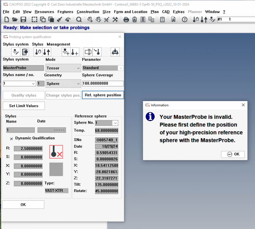

[Ri...] Posted December 9, 2024 Share Posted December 9, 2024 (edited) Over the weekend IT must have made updates, this causes the PC to reboot even if the CMM is active. Now I have lost all of my probes including the Master Probe (It was a new setup; I had not backed up anything). Somehow, my XTR setup became an RDSXXT setup. I have recreated the XTR tab, and it generates a Master Probe automatically. But for some reason its "Invalid"? How do I make the Master Probe valid when I can't use the Master Probe on the Reference Sphere? Edited December 9, 2024 Link to comment Share on other sites More sharing options...
[Ri...] Posted December 9, 2024 Author Share Posted December 9, 2024 Looking at the Master Probe values, it appears the XTR and RDSXXT values are mixed together? Link to comment Share on other sites More sharing options...
[Ri...] Posted December 9, 2024 Author Share Posted December 9, 2024 I ended up creating a new machine tab. Link to comment Share on other sites More sharing options...
