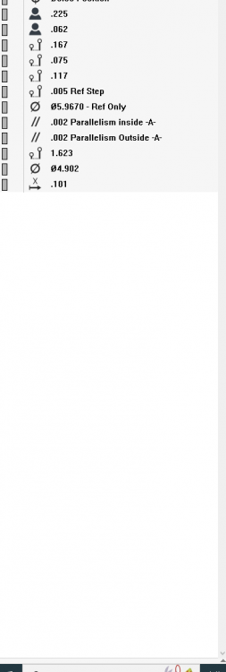

[Jo...] Posted December 9, 2024 Share Posted December 9, 2024 I cannot find the solution to the get back the "run" button (see picture) Please if you have any idea how to solve this problem. Thanks !! Link to comment https://qualityforum.zeiss.com/topic/21454-calypso-2024-software-run-button-missing/ Share on other sites More sharing options...

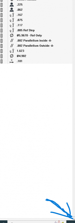

[Ya...] Posted December 10, 2024 Share Posted December 10, 2024 Try to Click the small arrow on the bottom right. Hope that helps 😊 YM Link to comment https://qualityforum.zeiss.com/topic/21454-calypso-2024-software-run-button-missing/#findComment-122352 Share on other sites More sharing options...

[Jo...] Posted June 24 Share Posted June 24 Wait till you see what the little arrow on the right side of the screen does! 🙂 Link to comment https://qualityforum.zeiss.com/topic/21454-calypso-2024-software-run-button-missing/#findComment-152095 Share on other sites More sharing options...
[Te...] Posted June 30 Share Posted June 30 Here is quick little document I created, please remember that you can select run from the tool bar, drop down menu and F8 on the joystick Rev is in honor of the student who lost it and is kind of a joke because he was an old co-worker that I can now bust his chops 🙂 Missing Run Button Rev Wade 01.pdf Link to comment https://qualityforum.zeiss.com/topic/21454-calypso-2024-software-run-button-missing/#findComment-152317 Share on other sites More sharing options...
[Za...] Posted June 30 Share Posted June 30 Here's an article on the topic for anyone visiting this thread in the future. https://portal.zeiss.com/knowledge-base?id=3525316 1 Link to comment https://qualityforum.zeiss.com/topic/21454-calypso-2024-software-run-button-missing/#findComment-152323 Share on other sites More sharing options...
