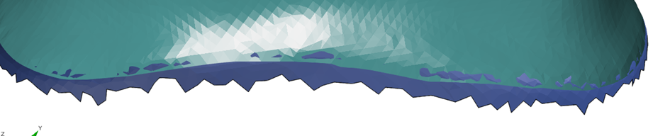

[Já...] Posted December 18, 2024 Share Posted December 18, 2024 I have the issue that sometimes, even though I apply the "Use all selected points", I still get some penetration (negative surface deviation). The image shows a dental crown design (green, actual) seated on the abutment (prepared tooth, nominal). How can we totally avoid this? Best Regards, Janos Link to comment https://qualityforum.zeiss.com/topic/21460-local-best-fit-with-tolerances-expert-parameter-use-all-selected-points/#findComment-122838 Share on other sites More sharing options...
[Jo...] Posted January 2, 2025 Share Posted January 2, 2025 Please sign in to view this quote. Hi, The green is atual mesh and blue is nominal? What do you want avoid? negative surface deviation? Best regards Link to comment https://qualityforum.zeiss.com/topic/21460-local-best-fit-with-tolerances-expert-parameter-use-all-selected-points/#findComment-123214 Share on other sites More sharing options...
[Já...] Posted September 28 Share Posted September 28 Yes, I want to avoid penetration. That is why I used best fit with tolerance, either using the outer function or setting the lower limit to zero. Link to comment https://qualityforum.zeiss.com/topic/21460-local-best-fit-with-tolerances-expert-parameter-use-all-selected-points/#findComment-156179 Share on other sites More sharing options...
