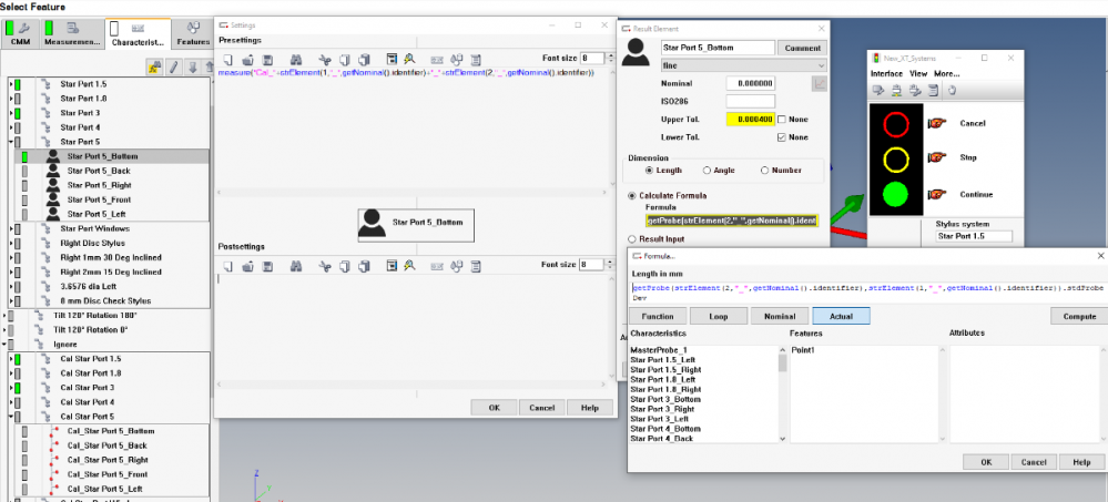

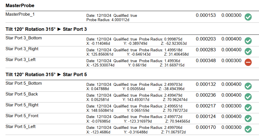

I'm curious what others may have come up with. I've found Zeiss's lack of nice calibration reports disappointing and makes training difficult. For others in a Production Facility this may be something you like.
Side benefit, since the S Value is in a characteristic now... turn on the table files or PiWeb exporting to actually track all your CMM Calibrations...
I'd love to see anybody else's similar projects!

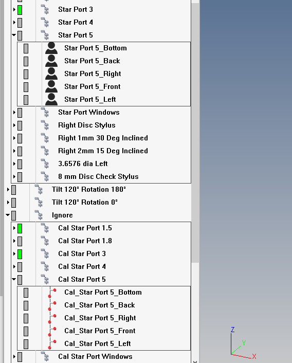

The Presettings of the result element has the measure() function, that runs the calibration Characteristics, for this to work the program must be set to run from Characteristic List. The names have "_" to use as delimitators so I can reuse the code.
I don't actually care to track x,y,z or anything else that's why they are in the comment... if you wanted to you would just make a Result element for each thing you want to track.
