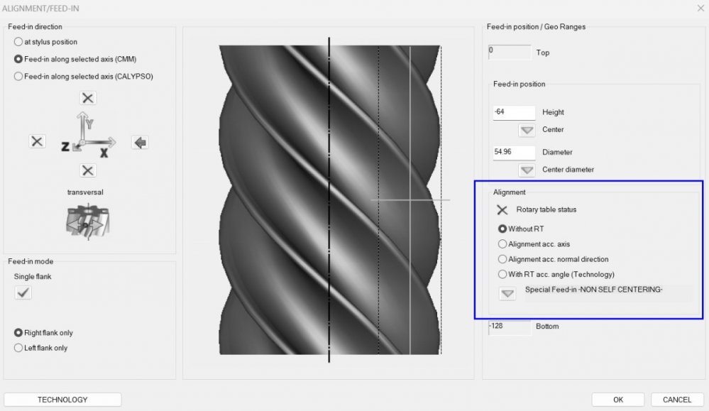

I keep getting a 6023 23 error message on the lead in. The probe goes to the root diameter comes out to the right diameter on the rotor and makes contact with the alignment point but then just floats off in the opposite direction and I get the error message. Any help?

An alternative "quick" test would be to rotate the rotor via several degrees and try the feedin in again. I remember that this helped in the past.

You can try to rotate the part as I already mentioned or you can try an alternative possibility for the feedin (see screenshot).
If nothing of this helps, please install the latest patch or update to a newer GEAR PRO version.
