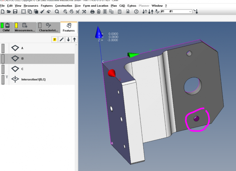

[Ra...] Posted December 13, 2024 Share Posted December 13, 2024 Hello, When I select a plane, another feature (a cylinder) is selected. How can I separate these features? I'm using Calypso 2022. Thank you, Link to comment Share on other sites More sharing options...
[Ju...] Posted December 13, 2024 Share Posted December 13, 2024 If you go to CAD>Extract, does it extract both features as a single feature? Link to comment Share on other sites More sharing options...
[Cl...] Posted December 13, 2024 Share Posted December 13, 2024 Try healing the model. Link to comment Share on other sites More sharing options...
[Ma...] Posted December 13, 2024 Share Posted December 13, 2024 Does it matter? Perhaps it's selected because of used intersection Link to comment Share on other sites More sharing options...
[Cl...] Posted December 13, 2024 Share Posted December 13, 2024 Whenever I have issues with the model I heal it. Sometimes it works, sometimes not. Link to comment Share on other sites More sharing options...
[Ma...] Posted December 16, 2024 Share Posted December 16, 2024 It doesn’t matter. Calypso will only use the feature extracted. Healing will probably help but don’t worry about it. Link to comment Share on other sites More sharing options...
