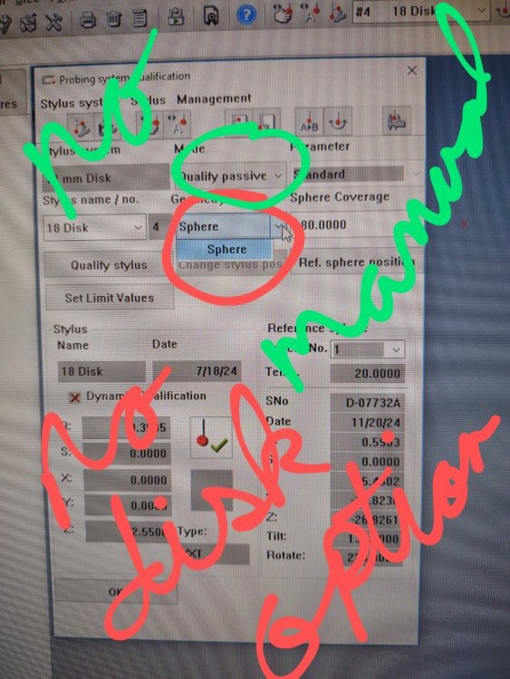

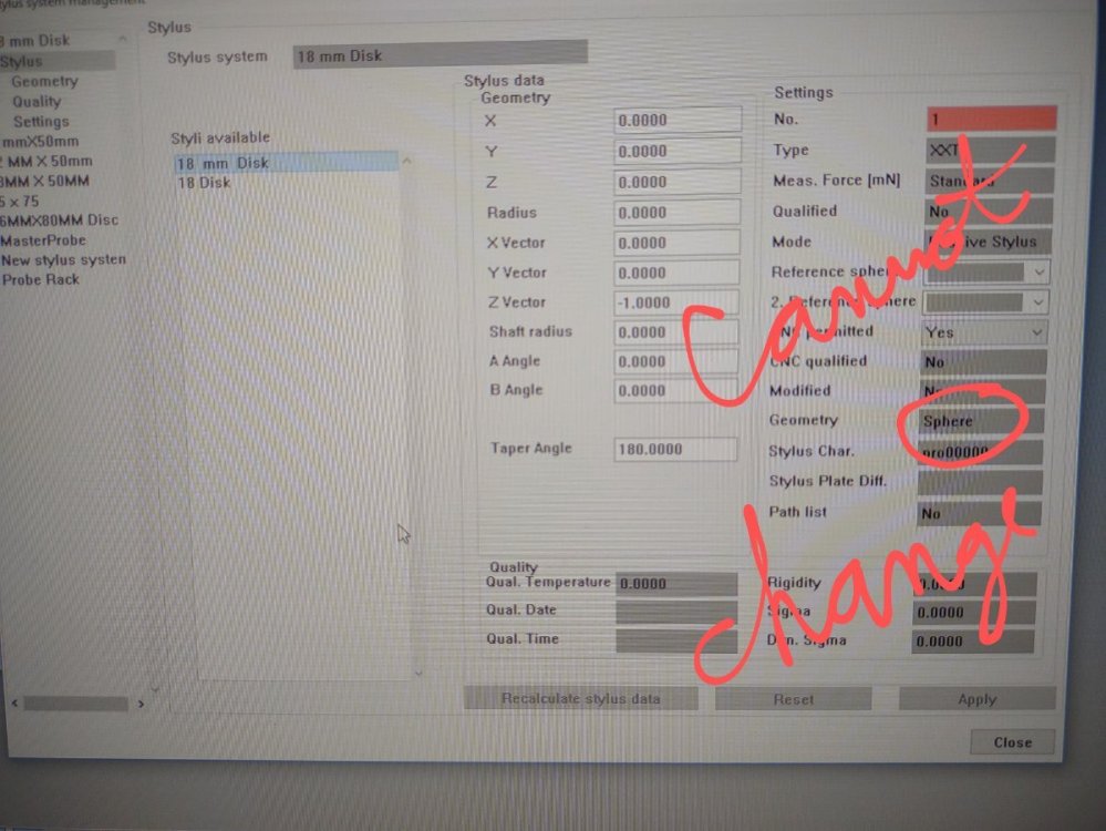

[Ro...] Posted December 14, 2024 Share Posted December 14, 2024 New job has an XXT rotating head. There is a couple disk probes in the rack, but the previous programmer never set them up. When I tried to set them up, there's no options to create anything but a spherical styli. Disk and cylinder are not an option. So what gives? What do I need to make a disk probe work? Link to comment Share on other sites More sharing options...

[Ro...] Posted December 15, 2024 Author Share Posted December 15, 2024 My last CMM was a vast XTR (which by the way is my favorite CMM head I have ever worked with) and I had the option of sphere, disk, and cylinder. I also had the option of a manual qualification on my disk so I can take manual points and the CMM would repeat those points for qualification. It was a good system, I don't know why the XXT doesn't give me the same options. Link to comment Share on other sites More sharing options...
[To...] Posted December 15, 2024 Share Posted December 15, 2024 Please sign in to view this quote. I believe the issue comes down to the deflection methodology for qualifying styli on an XXT sensor. I'm guessing it didn't meet the high standards of the Zeiss name. Link to comment Share on other sites More sharing options...
