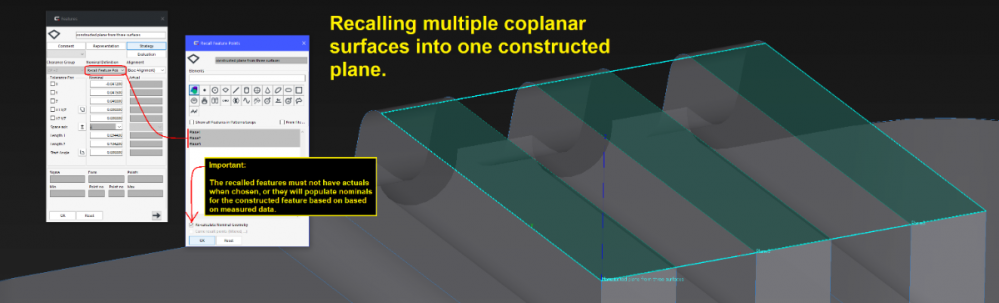

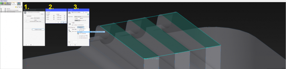

[Je...] Posted December 17, 2024 Share Posted December 17, 2024 Lincoln, Great questions about this profile characteristic. A refinement in the wording would be that profile with no datum constraint controls form. As you mentioned, this equates to flatness for planar features, but it could be applied to other types of features to control form. According to ASME Y14.5, the "14 surfaces" note means that the controlled feature is a constructed plane made from 14 coplanar surfaces. I would recommend recalling the measured points from all 14 surfaces into one plane feature. Important: make sure that when you initially recall the 14 surfaces into one "blank" plane feature that the 14 surfaces do not have actual data populated, because the nominals for the constructed plane will reflect the measured data rather than the nominal data. This can be manually correct by typing in the correct nominal values, but it's easier to avoid needing to do so. At this point, yes, you could create a flatness characteristic and recall the constructed plane feature. However, to go the extra mile and please your customer, I would recommend the following: 1. Create a "Geometry Best Fit" alignment. 2. Click on "Select Elements" and choose the constructed plane. 3. Click on "Evaluation Constraints" and make sure that all six degrees of freedom are selected (they already will be). 4. Then, create a profile characteristic and choose your constructed plane. Then, use the drop-down menu to choose the Geometry Best Fit alignment you just created. Enter the tolerance as specified on the print, but understand that the result will compute based on twice the largest deviation from the nominal profile (an oft-argued behavior throughout manufacturing 🤣). Good luck. Let us know how this turns out for you! Link to comment Share on other sites More sharing options...

[Je...] Posted December 18, 2024 Share Posted December 18, 2024 Please sign in to view this quote. Lincoln, that's an interesting development. Is there more you can share about this? How did they intend to define the characteristic? Link to comment Share on other sites More sharing options...
[Ja...] Posted December 18, 2024 Share Posted December 18, 2024 Please sign in to view this quote. Use the same surface as the datum in the profile characteristic. If the evaluation methods (LSQ, Min Feature, Max Inscribed, etc.) for the features are the same then the results for profile and flatness should match. Flatness defaults to Minimum Feature, older versions of Calypso will let you change the dropdown but it would still evaluate the plane with minimum feature regardless of what you chose. In 7.2, and later versions I assume, it will evaluate flatness with whatever evaluation method you choose. Link to comment Share on other sites More sharing options...
