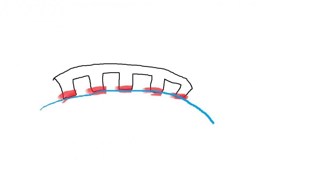

[Ma...] Posted January 6, 2025 Author Share Posted January 6, 2025 Please sign in to view this quote. I have added a very poorly drawn picture of what i'm trying to explain. So the part is drawn in black, the red is the lasso box i want to pattern , and the blue is the theoretical circle im trying to create. Now there are about 30 of these lasso boxes id have to create and i was wondering if it was possible to just draw one lasso box then pattern it onto the other remaining sections to retrieve data from those points. I am doing a profile scan of the whole part so im deriving the points from the scan. Link to comment Share on other sites More sharing options...

[Ma...] Posted January 7, 2025 Author Share Posted January 7, 2025 Please sign in to view this username. This doesn't quite fall into what i was looking for. This isn't ideal when you are trying to derive points to create a circle. The video above helps with High form value. I'm trying to get a radius value by recalling feature points from a 2D curve using the lasso tool on multiple teeth along a circular part. I want to know if its possible to do a circular pattern for a lasso box so i don't have to create 30 separate lasso boxes Link to comment Share on other sites More sharing options...

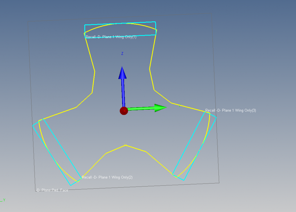

[Mi...] Posted January 7, 2025 Share Posted January 7, 2025 (edited) Scan the data however you need which the feature that makes sense. Create a duplicate feature, Recall Feature Points the area you want with a box, probably slightly bigger than you need. On that feature, apply the appropriate pattern, in my case 3x 120 degrees. The RFP box will move with the pattern, now you will have multiple RFP features... 3 planes in my example. Then, you can RFP again on the patterned feature, this will recall them into a single feature you can use for evaluations. Watch the filter and outlier settings, you may find you have to setup the outlier as if it's a line/plane not a circle for it to execute. I'm scanning this entire face for some evaluations, but I wanted to separate just the outer portions for specific measurements, without rescanning. Edited January 7, 2025 Link to comment Share on other sites More sharing options...

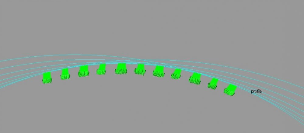

[Ma...] Posted January 7, 2025 Author Share Posted January 7, 2025 So how can i confirm that i didn't just pattern the points? It looks good though. Link to comment Share on other sites More sharing options...
[Mi...] Posted January 7, 2025 Share Posted January 7, 2025 Please sign in to view this quote. Report something like roundness from the feature with the pattern, you should get 11 Roundness characteristics each with a different result when you view the report... might have to increase the decimal count. Link to comment Share on other sites More sharing options...
