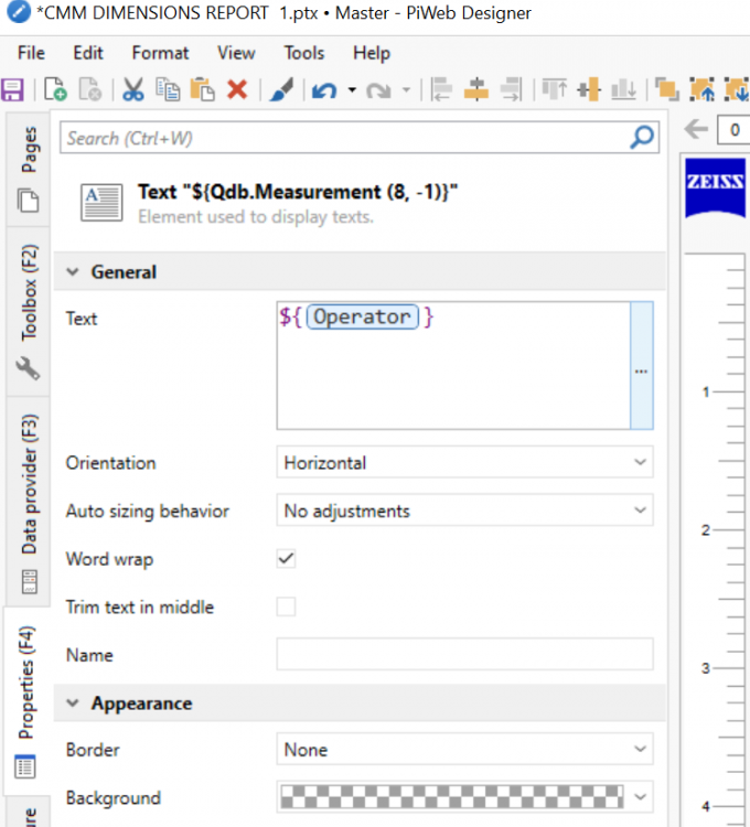

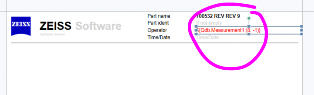

[Ra...] Posted January 3, 2025 Share Posted January 3, 2025 Hello, Do you know how to change the text from "Operator" to a specific name? I've noticed that learning a Piweb report involves going through a lot of documentation. For now, I only need to modify the name field. I attempted to edit the report, but the option isn't working. Any other recommendations? Thank you! Link to comment Share on other sites More sharing options...
[DW...] Posted January 3, 2025 Share Posted January 3, 2025 Just out of curiousity, do you want to select from a group of names before the run and then have the selected "operator" fill in the header, or are you looking to statically replace "operator" with a single name? 1 Link to comment Share on other sites More sharing options...
[Ra...] Posted January 7, 2025 Author Share Posted January 7, 2025 I'm looking to statically replace "operator with a single name. Link to comment Share on other sites More sharing options...
[DW...] Posted January 7, 2025 Share Posted January 7, 2025 (edited) Where it says "Text" and then Qdb.Measurement... just delete all of that and write the name. Hit F5 to preview. Edited January 7, 2025 Link to comment Share on other sites More sharing options...
[Ky...] Posted January 8, 2025 Share Posted January 8, 2025 This "Operator" item is actually tied to the "user" in Calypso. There are ways to define it to be a particular name, even if you don't use a different Calypso user for every inspector. https://portal.zeiss.com/knowledge-base?id=2361758. Link to comment Share on other sites More sharing options...
[DW...] Posted January 9, 2025 Share Posted January 9, 2025 Please sign in to view this quote. Oh yea I forgot about mapping custom variables. OP do this instead. Link to comment Share on other sites More sharing options...
