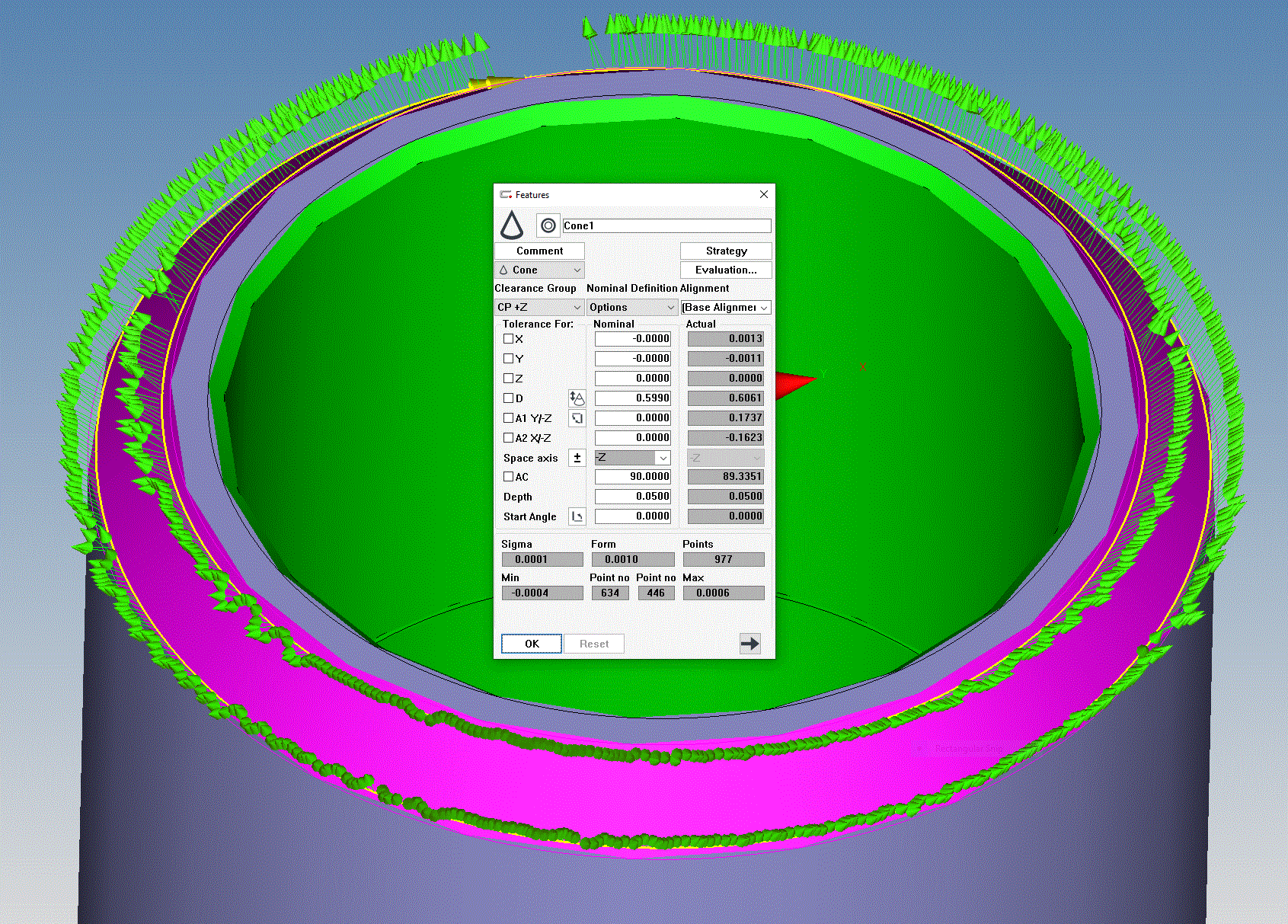

Hello Everyone,
So I am working on a few chamfer angles. The blue print call out is 0.50 which is what the CAD model shows. Now in the display it shows depth 0.050 but there is no check box. Is there a function to measure this in a simple manor? In the past what I did was create two circles one at top and one at bottom. Thanks for any info!
Lou
You can intersect the shell of the cone with the OD, then look at the distance from that intersection to the end plane.
