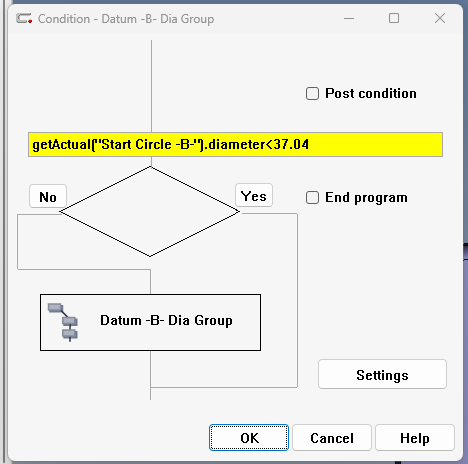

[Ri...] Posted December 15, 2025 Share Posted December 15, 2025 Please sign in to view this quote. For those who have a slightly different install: (Example) C:\Program Files (x86)\Zeiss\CALYPSO 7.4\userinfo\manuals\en-US 1 Link to comment https://qualityforum.zeiss.com/topic/21676-pcm-command-list/#findComment-143669 Share on other sites More sharing options...

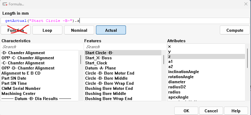

[Sv...] Posted February 6 Share Posted February 6 Is there also a list of which commands work without a PCM license? 1 Link to comment https://qualityforum.zeiss.com/topic/21676-pcm-command-list/#findComment-145735 Share on other sites More sharing options...
[Jo...] Posted February 6 Author Share Posted February 6 (edited) Please sign in to view this username. Not 100% sure, as I have always had the PCM Lic. I believe any strings you can place in the formula window, as well as the condition window, is apart of the free PCM. You should also be able to place if/then logic statements here as well. I believe you are locked out of the Pre/Post setting PCM areas and functions as well. Edit: This also works within result elements as well. Edited February 6 Link to comment https://qualityforum.zeiss.com/topic/21676-pcm-command-list/#findComment-145745 Share on other sites More sharing options...
