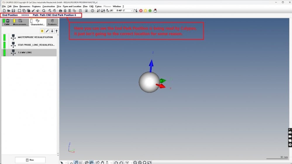

[Dy...] Posted January 9 Share Posted January 9 So, I'm programming a Contura G2 with the VAST XXT head and I've always had an issue with the Geometry RE-Qualification Program that we learned how to write in Calypso Advanced. It worked fine in class, as far as I can remember, but when I run this program on the CMM here at home, it always ignores the End-Park Position. This is the only program I've had this issue with. I've tried multiple ways to avoid hitting the limit switch with the End-Park Position, but nothing is working. I have to be ready for the final stylus system to finish, and manually stop the head from moving to the limit switch. As I'm typing this, I'm running a version where I've manually added positioning points to the reference sphere feature, but i don't have much hope that this will work either. Any idea?? -TIA Btw, I did see other posts related to this topic but none related closely enough to my situation. Thanks, -Dylan Link to comment Share on other sites More sharing options...

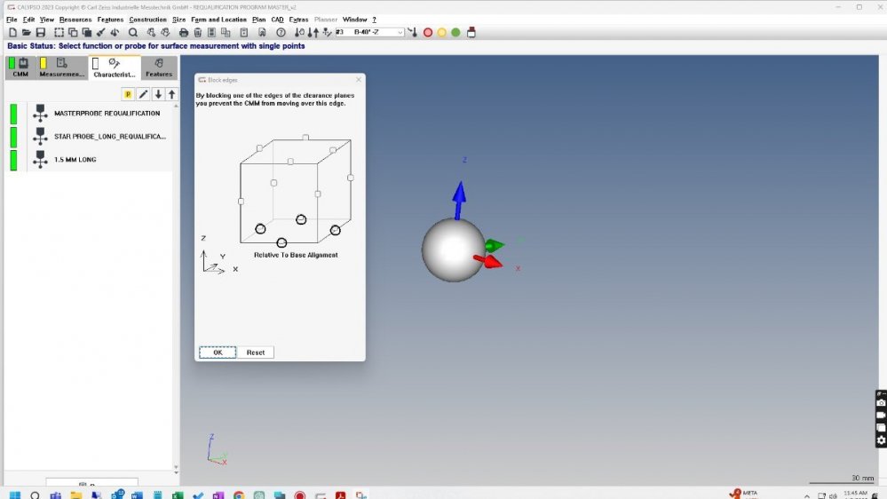

[DW...] Posted January 9 Share Posted January 9 (edited) Please sign in to view this quote. Screenshot Plan>Navigation>Block Edges Edited January 9 quotes Link to comment Share on other sites More sharing options...
[Dy...] Posted January 9 Author Share Posted January 9 Please sign in to view this quote. In the first photo, you can see that Calypso is reading the End Park Position. Second photo shows the Blocked Edges you requested, however, I'm unsure how this would affect the End Park Position. Link to comment Share on other sites More sharing options...

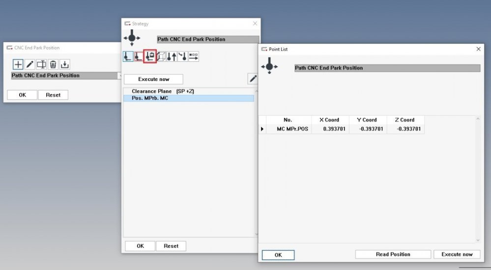

[To...] Posted January 9 Share Posted January 9 Which icon are you using in the End Park Position. My guess is you won't be able to use either of the 1st 2 icons that are relative to a base alignment. The 3rd icon would be relative to the machine coordinates. Link to comment Share on other sites More sharing options...
[Mi...] Posted January 9 Share Posted January 9 I think along the same lines as Tom. Calibration program likely has no Base Alignment, so it doesn't have a proper reference. I would think the only position you can use the the one with MK on the button. Link to comment Share on other sites More sharing options...

[To...] Posted January 13 Share Posted January 13 (edited) Please sign in to view this quote. Earlier versions of Calypso used the MK from German abbreviation of Maschinenkoordinaten. In 2023, it shows an icon of a machine silhouette. The X, Y and Z coordinates are in the machine's coordinate system where the home is X0, Y0 and Z0. Edited January 13 Link to comment Share on other sites More sharing options...

[To...] Posted January 13 Share Posted January 13 (edited) You shouldn't need to run a manual alignment. I think I would start over but not completely. Leave the 1st program open. Create a new program. Go back to 1st program and copy the 3 probing qualifications. Go to new program and paste the probing qualifications into the characteristics list. Move the stylus system to the desired parking location Select Plan from the menu, then Navigation, then CNC End Park Position Click the + sign to add a new strategy. Click the 3rd icon from left on top row. Click OK to close everything. Click run. In right column, select Run from Characteristics list, Use Position Points, Normal and 80mm per second (1st time through) In center column, tick "clear existing results. In left column, run Current Alignment, All Characteristics, Start. Edited January 13 Link to comment Share on other sites More sharing options...

[Dy...] Posted January 23 Author Share Posted January 23 (edited) Please sign in to view this quote. Sorry for the delay guys! We've been needing a repair on X and Y drives for quite some time now, and I totally forgot the technician was scheduled to come in last week and this week. But, this solved my issue!!! Thanks Tom!!! It was the "Use Position Points" selection in the Run Menu. I thought this option would only be selected if you manually define the travel path with Positioning Points. Once I selected this option, the End Park Position worked perfectly. This leads me to my next question. Why is this the only program I have to select this option to enable the End Park Position? And what exactly is it doing? TIA!! -Dylan Edited January 23 Link to comment Share on other sites More sharing options...
[Je...] Posted January 23 Share Posted January 23 Because a Qualification program doesn't have any features. CNC End Park executes after features are complete. A qualification characteristic doesn't have a corresponding feature to execute. Link to comment Share on other sites More sharing options...

[To...] Posted January 24 Share Posted January 24 (edited) End Park Position relies on the origin of the base alignment. Even though the Probe Qual program, doesn't use a base alignment, bit still refers to a coordinate system, which is the machine origin, in the back upper left corner of the machine volume. I'm only guessing here, if you ran from Clearance planes, you must have opened the Base Alignment window (maybe left it blank), then created a clearance cube, otherwise the program wouldn't run. This means at the end of the run, the first move is to get to the +Z clearance plane which will be above the Z+ limit, which is probably where your program always stopped. It never had a chance to make it to run the park position. Edited January 24 Link to comment Share on other sites More sharing options...
