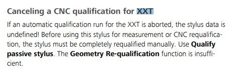

[No...] Posted January 14, 2025 Share Posted January 14, 2025 (edited) Are we talking about an XXT head? One thing I remember from reading some older release notes is that if the CNC calibration of an XXT tip is cancelled for whatever reason, the stylus data is undefined and has to be recalibrated MANUALLY in passive mode (repeat calibration is not sufficient). I don't know if this still applies, as that passage is missing from newer release notes, but it might be worth checking. Edited January 14, 2025 Link to comment Share on other sites More sharing options...
[Da...] Posted January 14, 2025 Author Share Posted January 14, 2025 Clarification: My issue is with alignment issues within my CALIBRATION programs. The "weekly calibration" and "super calibration" programs are in 'passive mode'. So, better than 1 month ago, the "blue collar" 3x50 that came with the machine (and was my original 3x50) broke, so I just installed the other 3x50 and thought THAT would calibrate OK, and all the tips did. Are you saying that maybe I need to completely delete my 3x50 calibration and start over from scratch each time a tip fails on calibration?? Man, THAT will be a pain! Link to comment Share on other sites More sharing options...
[No...] Posted January 14, 2025 Share Posted January 14, 2025 No, you don't have to delete anything. But (possibly) fully recalibrate a stylus manually in passive mode ONCE in case you cancelled its CNC calibration midway. From the 6.8 release notes (the last one containing this note): Link to comment Share on other sites More sharing options...
