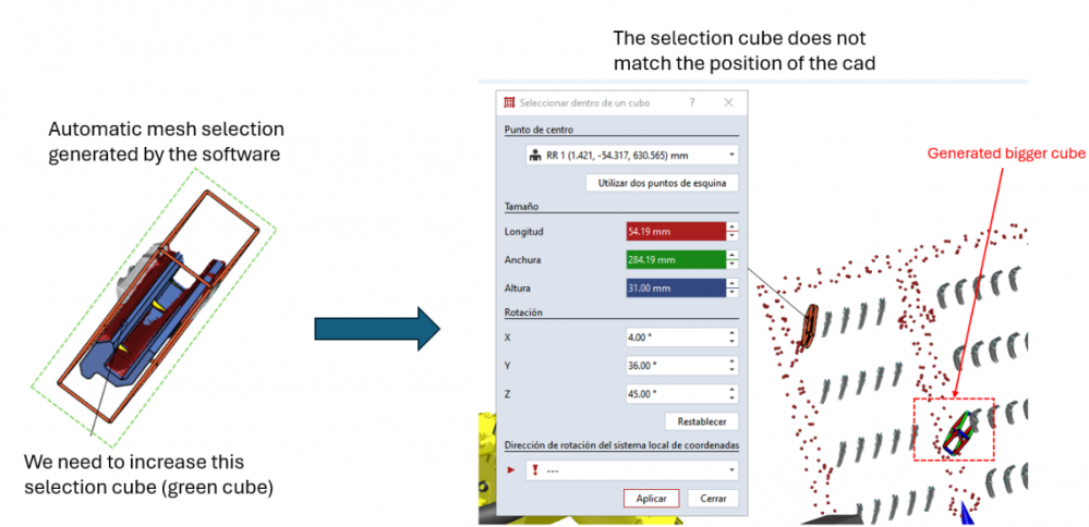

[Mi...] Posted January 14, 2025 Share Posted January 14, 2025 Dear forum Members, We are scanning several pieces at the same time and we need to increase de volume of the automatic mesh selection generated by the software. We have tried to generate a cube to select the scanned mesh, but the position in which the cube is generated does not match that of the CAD. Can anyone help us increase the mesh selection? Thank you, Mikel Link to comment Share on other sites More sharing options...

[Be...] Posted January 16, 2025 Share Posted January 16, 2025 Hi, this can only be achieved by scripting: # Example for modifying an existing cube selection -> # box_selection_scaling is optional, box_coordinate_extension is also optional # at least one of the parameters should be set # Do it by scaling for all axes the same scaling factor: 30% bigger than the bounding box of the CAD gom.script.atos.set_box_selection_scaling_for_polygonization (box_selection_scaling=1.3, part=gom.app.project.parts['PartName']) # Do it by extending with absolute values (in mm) for all three axes gom.script.atos.set_box_selection_scaling_for_polygonization ( box_coordinate_extension = gom.Vec3d (10, 5, 10), part=gom.app.project.parts['PartName']) Hope this helps?! 1 Link to comment Share on other sites More sharing options...
