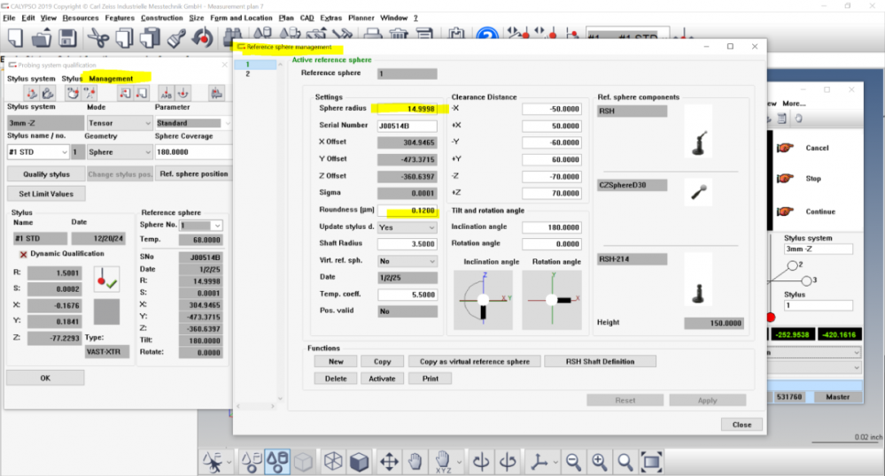

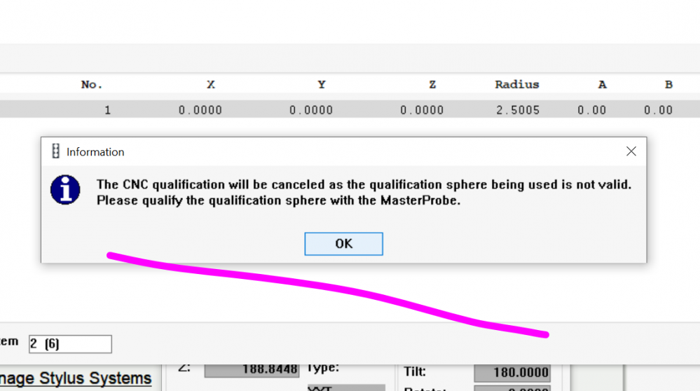

[Ra...] Posted January 14 Share Posted January 14 (edited) I'm using CMM and Calypso 2022. I've been receiving an alert when trying to perform the CNC requalification. The machine successfully completes position #1, but when it moves to position #2, I get the alert. All other positions 3,5 and 5 are in green. Yes, I'm using the master probe to qualify the probe. This doesn't make sense to me, and I'm not sure how to proceed. Can you offer any guidance?  Edited January 14 Link to comment Share on other sites More sharing options...
[Ju...] Posted January 14 Share Posted January 14 Are all of the styli assigned to the same reference sphere? Link to comment Share on other sites More sharing options...
[DW...] Posted January 14 Share Posted January 14 Screenshot your reference sphere management window. Link to comment Share on other sites More sharing options...
