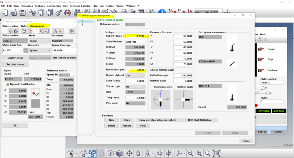

Go to your reference sphere management.. Does the highlighted value in your software match the value of your reference sphere certificate?
Sorry, I can't find certs...I found a cert for one of our 3 spheres but it is pretty outdated cert and it is for our smallest sphere (8mm sphere for calibrating 1mm probes). The radius is off by 0.00044196mm and the roundness is off by 0.058 microns.
Perhaps our other calibration spheres are off even more. I guess I have no way of knowing if this is what is causing the issue without sending the spheres out for calibration?
Yes, without the certificates you have a big unknown value in your sphere radius. The number supplied by the Zeiss certificate would be input by you as the operator when setting up your spheres to allow the software to do its calculations. It might be worth calling the Zeiss 800 number or reaching out to
. The other option would be to have it calibrated by a reputable lab that you trust. Keep in mind, the theory of the value being off in your sphere management is just a beginning point when troubleshooting your initial comments.
