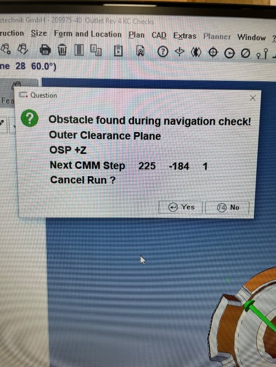

[Ro...] Posted January 14 Share Posted January 14 (edited) I am having a hard time with a program running. It was on a different CMM and I pulled it into the one I am trying to run it on, yet I keep getting the following error as in the picture. The program contains 2 different probes. It runs the first probe without a problem, changes probes and instantly I get this error. Nobody can figure out what is going on with it. We have deleted and brought in the program multiple times, shut down Calypso multiple times, rebooted the computer multiple times and still get this error. Yet, when we run the program on the machine it is pulled from, it runs perfectly every time. Any help is appreciated. Edited January 14 Link to comment Share on other sites More sharing options...
[Ma...] Posted January 15 Share Posted January 15 What is checked on Plan->Navigation->Navigation check ? Link to comment Share on other sites More sharing options...
[Cl...] Posted January 15 Share Posted January 15 Are both machines the same size and model? Link to comment Share on other sites More sharing options...
[Ro...] Posted January 15 Author Share Posted January 15 Please sign in to view this quote. The one the program was on originally is a Duramax. The one we put it on is a Contura G2. Link to comment Share on other sites More sharing options...
[Ro...] Posted January 15 Author Share Posted January 15 Please sign in to view this quote. All 3 boxes are checked. Link to comment Share on other sites More sharing options...
[Ma...] Posted January 15 Share Posted January 15 Please sign in to view this quote. I had an problem when i check something - it was automatically printing similar message. Had to uncheck navigation path to be able to run it. Link to comment Share on other sites More sharing options...
