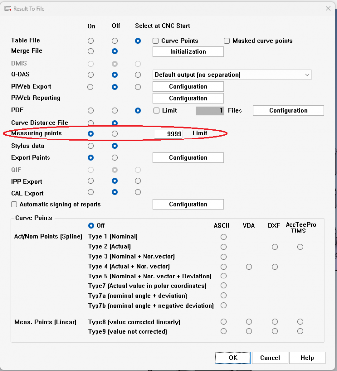

[Ri...] Posted January 16, 2025 Share Posted January 16, 2025 Is there a specific file I can read to find the counter for saving measure points (ZMP files)? I have about 100 plus files I want to change the value in without having to open, edit, save, close. If this is possible, I would write a VBS app to perform the editing. Link to comment Share on other sites More sharing options...

[na...] Posted January 17, 2025 Share Posted January 17, 2025 Please sign in to view this quote. Please sign in to view this quote. He wants to turn it on. Richard, take a look inside inspset file, (NOT the same as inspection) the line #( #maxFilesMeasPoints ' ->' 99999) But I'm unsure this is all. Please test and report back. Best Regards, Dane Link to comment Share on other sites More sharing options...
[Jö...] Posted January 17, 2025 Share Posted January 17, 2025 Hallo Richard , Versuch es mal mit Notpad++ damit kannst du mehrfach Änderungen machen. Wurde im alten Forum schon gefragt. Du musst nur wissen, wie genau der Teil heißt den du ändern möchtest. Ich glaube, Florian Leitner hat das mal für die Taster Umbenennung gemacht. Du musst in der ( inspection oder inspset )schauen, wo es steht. Und wie immer eine Sicherung vorher machen. Gruß Jörg Link to comment Share on other sites More sharing options...

[Ri...] Posted January 17, 2025 Author Share Posted January 17, 2025 DWC Replace the current counter value, ZMP files is already enabled. na_vor The string you provided (#maxFilesMeasPoints) seems to work, I was able to replace the value in one program correctly. Jörg Apfelbach I am an avid user of NotePad++. 😉 Thanks to all. Link to comment Share on other sites More sharing options...
