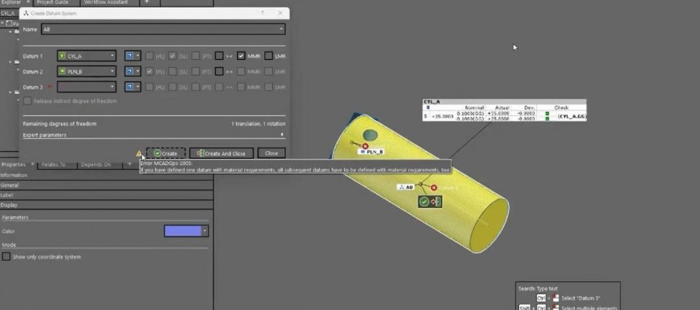

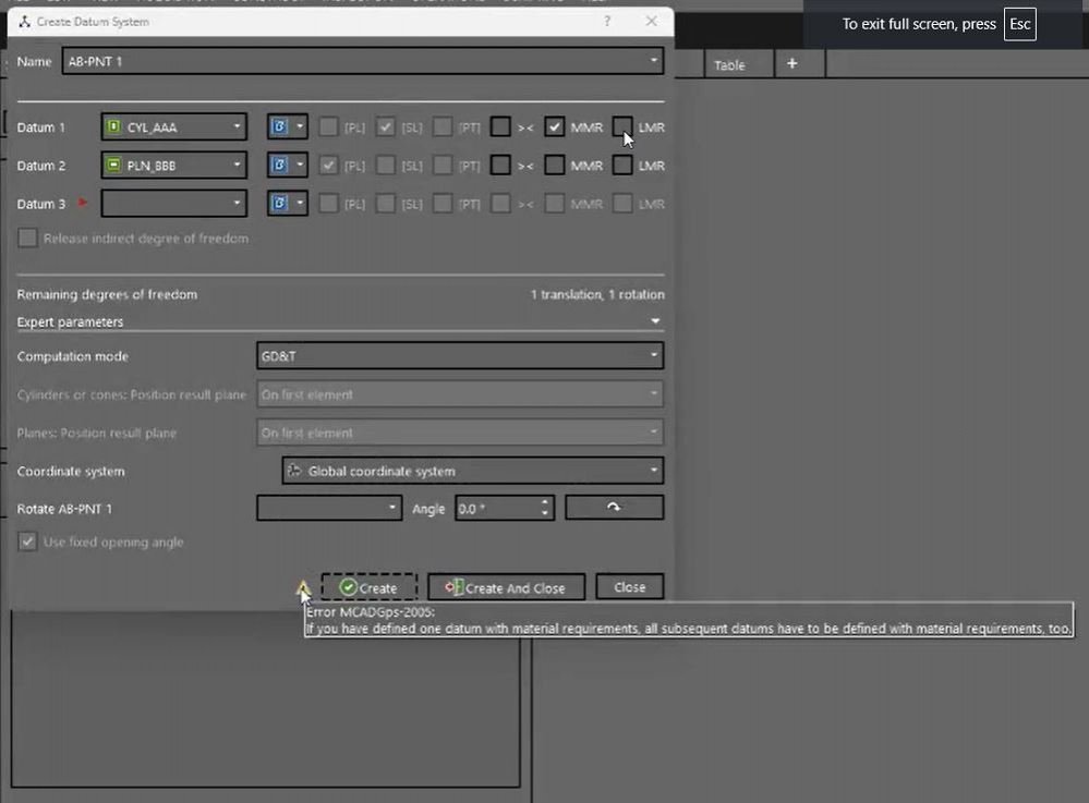

[Ti...] Posted January 21, 2025 Share Posted January 21, 2025 (edited) There is a problem with the software in my opinion when is comes to datum shift. When you apply MMR to a cylinder similar to what is described here: https://qualityforum.zeiss.com/topic/5042-mmc-vs-mmb/?do=findComment&comment=56526 If the cylinder is the only datum, the MMR application works fine. but if you apply a clocking/rotational datum as a secondary datum the software fails and says that any subsequent datums must have a material requirement size stated as well(see imaged). This is not true. You can allow for a primary datum to shift while being constrained in rotation. If you disagree imagine hard gaging a rotor in the link above with a flat clocking side. The flat would only allow for datum shift in two directions just not rotaionally. When I apply a MMR condition to the clocking mid plane, I still get a violation of virtual condition error. I probably need to escalate this and also Zeiss inspect needs to also allow us to apply MMC conditions to non-features of size. This is a problem for us using he software everyday. PCDMIS allows for you to create bonus for a non-feature of size positional callout and you can do it in Calypso it seems: https://qualityforum.zeiss.com/topic/21284-mmc-bonus-on-a-non-feature-of-size/#comment-121536 I'm not trying to yell at you guys at GOM, I just want to make you aware of what we need in the field....I need to be able to apply bonus to non-feature of sizes for terribly GDT callouts that I see everyday, and I need to be able to use datum shift when I have a clocking datum as a secondary datum. With .03mm tolerances I need all the datum shift I can get! Any btw...I don't like the fact that when you use Datum shift or MMR on a datum you are required to use GDT as your measurement principle...from my understanding this re-measures the datum features using max inscribed for and ID and then Min Circum as the OD and for how small our features are this is unstable. I would prefer we can still use geometry and stick to the method we created the datum as is which I like LSQ as is. ---here is the documentation on the max ins and min circ unstable issue at hexagon: (search for the term 'unstable') https://docs.hexagonmi.com/pcdmis/2021.2/en/helpcenter/mergedProjects/core/geometric_tolerances/Evaluating_Size_with_the_Geometric_Tolerance_Command.htm Edited January 21, 2025 Link to comment Share on other sites More sharing options...

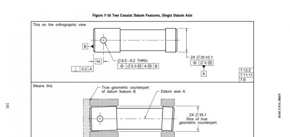

[Ti...] Posted January 22, 2025 Author Share Posted January 22, 2025 I just recreated this part from the ASME standard and GOM doesn't like the addition of Datum B to the AB datum reference frame. Here is a situation that you could hard gage a bore at this parts MMC size with a stop on the bottom for PLN B. Now you can jiggled that part around if the cylinder is made smaller until it is in line with the cyl A axis, and you can get the distance from datum B dialed in. But the software doesn't like this DRF setup for some reason. Link to comment Share on other sites More sharing options...
[na...] Posted January 22, 2025 Share Posted January 22, 2025 Please sign in to view this quote. Tim, I guess you tried already, sometimes Inspect wants the tertiary datum to produce result, even if not needed. Link to comment Share on other sites More sharing options...

[TI...] Posted February 24 Share Posted February 24 Yes it is still a problem...see below. Datum B is a plane and cannot have a MMB material requirement. I also don't like that you must use GDT(ASME or ISO) to measure the datum features. We use Guassian/Least Squares often from years of correlation with other methods like CMM/Vision, and also, surface quality of the mesh comes into big play when you use tangent(exterior highs) for features. It would be like taking 7 hit points on a plane on a CMM and constructing a tangent plane...you don't know if you actually hit enough of the plane to capture the highs. So sometimes it is prefered to use least squares. Link to comment Share on other sites More sharing options...
[Ma...] Posted February 24 Share Posted February 24 I don't know what purpose has Datum2, but avoiding it is helping. But if you need that point to set your origin, then i am out of ideas how to enable MMR on that single plane. Point / intersection with plane and cylinder to get a point is not working also. I understand why it needs MMR on all elements, but not sure how to enable that on single plane. Link to comment Share on other sites More sharing options...

[Ma...] Posted Wednesday at 06:42 AM Share Posted Wednesday at 06:42 AM Once you apply MMR on first element you have to apply it to all others. That's what i've observed Link to comment Share on other sites More sharing options...
[TI...] Posted Wednesday at 04:04 PM Share Posted Wednesday at 04:04 PM Yep, that is the problem with the software. You need to be able to apply datum shift to the above example for CYL A only. The two subsequent cannot have datum shift, they are not a feature of size. Link to comment Share on other sites More sharing options...
[Ma...] Posted Wednesday at 06:11 PM Share Posted Wednesday at 06:11 PM I've tried something - not sure if it's ok, but i've used CYL_A as last one. You can also check PLN_A and/or PLN_B as >< to control only rotation, which would suite for PLN_C. But i agree it's not correct or straightforward as in Calypso. Link to comment Share on other sites More sharing options...
