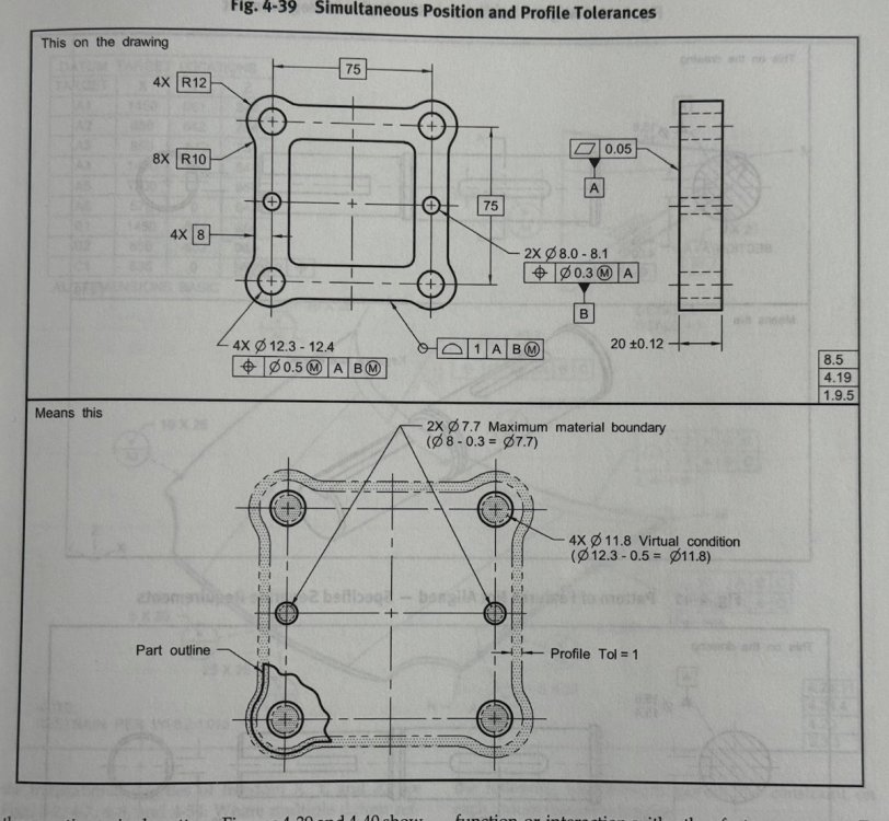

[To...] Posted January 21, 2025 Share Posted January 21, 2025 (edited) Found this in 2009. Full disclosure, there was no examples in the Profiles section. Just this paragraph. 4-39 appears to be tied to the position. Edited January 21, 2025 Link to comment Share on other sites More sharing options...

[Cl...] Posted January 22, 2025 Share Posted January 22, 2025 The Y14.5 Standard tells us that we cannot apply the MMC modifier to a profile tolerance because it is a surface control. We can, however, apply MMC or LMC to the datum references of a profile tolerance where the datum features are features of size. Link to comment Share on other sites More sharing options...
[Je...] Posted January 22, 2025 Share Posted January 22, 2025 Datum references do not get material condition modifiers, they get material boundary modifiers. MMB/LMB absolutely are applicable to Profile of a Line and Profile of a Surface requirements. The MMB modifiers allow for "shift" but not "bonus" tolerance applied 1:1 as MMC/LMC works traditionally. Based on the presented drawing, this isn't a "debatable" topic. Its clearly defined and if there are debates around this with your company and your customer, it would behoove you (read:your company) to take some basic & advanced GD&T courses (I'll shamelessly plug AGI here). I can confidently state that it will save you 10x more than the cost of the courses. Link to comment Share on other sites More sharing options...
[Je...] Posted January 23, 2025 Share Posted January 23, 2025 (edited) Mark, It sounds like you are faced with a challenging situation in not having access to the end customer but needing to understand their drawing. Great job on looking to peers on this forum for help. When a circled "M" is placed next to datums in a feature control frame, it is referred to as Maximum Material Boundary (MMB), which enables Datum Shift for datum features of size. While MMC (Maximum Material Condition) applies to the feature being toleranced, MMB (Maximum Material Boundary) is used to describe the boundary of the datum feature during datum shift. These two ideas are commonly confused. Datum shift does not add bonus tolerance to the controlled feature's stated tolerance, so the .004 profile tolerance is constant. Datum shift refers to the allowable movement of a datum feature simulator (datum mobility). Datum shift is commonly used in composite position tolerancing to provide flexibility in aligning datum simulators within allowable boundaries. It is equally valid for profile characteristics, where it enables greater manufacturability. While MMC is not permitted on profile characteristics, MMB is perfectly legal and is a great tool for ensuring functional alignment without over-constraining the part. In metrology software such as Calypso, the allowable movement (datum shift) is calculated mathematically using the MMB defined by the material modifier. You can enable datum shift within a characteristic setup in Calypso, where applicable. I hope this helps, and keep us posted on how this turns out. Here are some places in the ASME Y14.5-2009 standard to read more about datum shift: Section 4.4.3 (p. 56) Section 4.11.7 (p. 82) Edited January 23, 2025 Link to comment Share on other sites More sharing options...
