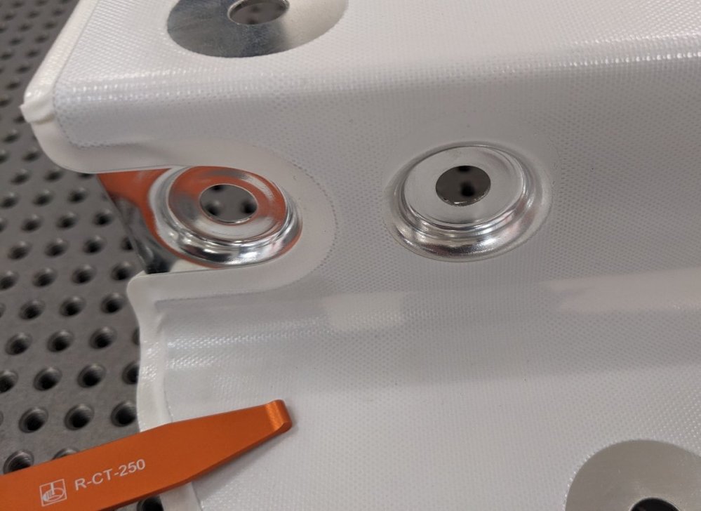

So, here's my issue; should be a simple program, since 38 out of 40 diameters are all in the #1 stylus direction, and the last 2 are in the #3 position. As for the story, I will refer to these a "left hole" and "right hole". BTW, I am staging this part sideways, so right is X+, towards you is Y-, even though I will be measuring this hole with the #3 (X+) stylus direction.
So, the first 26 holes are on the upper part of the program, with A|B|C alignment (you can see just a bit of one of them in the upper part of the pic), then there is the lower part on a D|E|F alignment (small part of one hole on the bottom of the pic). Program runs flawlessly with my 2mmx(20+50)mm cylinder probe on both levels and both alignments, no issue at all. Then, at the very end, I rotate to stylus position#3 to measure these side holes. I created them on the screen first, then ran each with an F9 command to make certain I had clearance and/or no collision, and it worked well. FWIW, my clearance planes are 20mm from CAD edges.
So, when running, after measuring the last 'flat hole', the machine moves to the Y- clearance limit, rotates to the correct direction, moves diagonally along the Y- clearance plane, then goes straight in the Y+ direction to measure the "right hole". After measuring, the head backs out (Y- direction) to the Y- clearance plane, then upward to the Z+ clearance plane, and.......stops. Nothing!
I tried switching the "right hole" with the "left hole" in the order on the Features window, but it still goes directly to the "right hole", completely ignoring the left hole.
I've tried everything; the alignments are both the same, strategies are the same, speeds, etc. I'm at a loss as to why the program just refuses to acknowledge the "left hole" at all. FWIW, both are aligned to the A|B|C top alignment (even though these are more of an (X,Z) type measurement, but both are...)and there seems to be no problem with the right hole measuring correctly.
Any ideas? It's either something glaringly obvious, or else something so obscure I just didn'y know what to look for.

I think I get what you are thinking. (runs over to the CMM......5 minutes elapse......runs back)  Yeah, found the problem; accidentally put the dimension measured down as the plane Datum D, dimensioned to....well, that was wrong. Changed it, and now it works.
