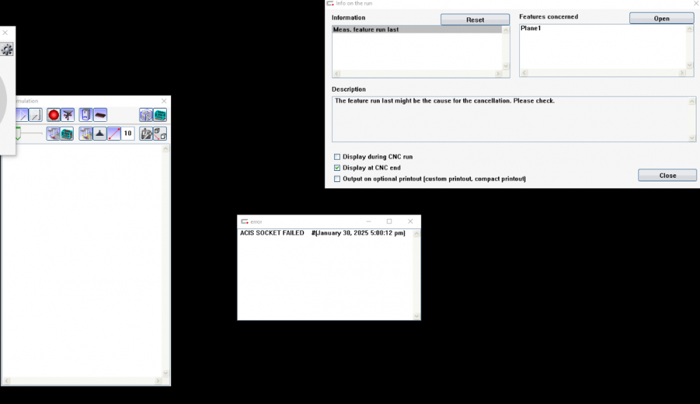

[Ma...] Posted January 30, 2025 Share Posted January 30, 2025 A little description would help more. Do you face it for the first time? Tried restarting Calypso/PC? Did it work at least once or is it first try? Is it planner or real machine switched to simulation mode? Link to comment Share on other sites More sharing options...

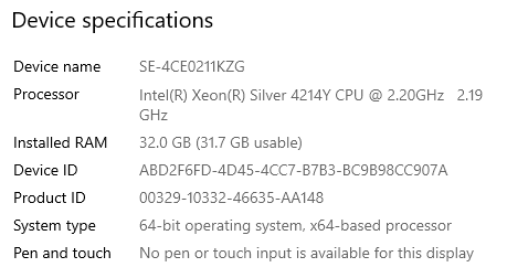

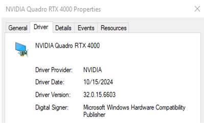

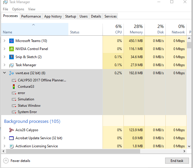

[Vi...] Posted January 30, 2025 Author Share Posted January 30, 2025 Hi Martin I tried number of ways to solve this issue, restarted multiple changed system but getting same issues. check attached snaps. Link to comment Share on other sites More sharing options...

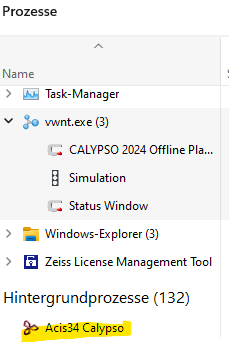

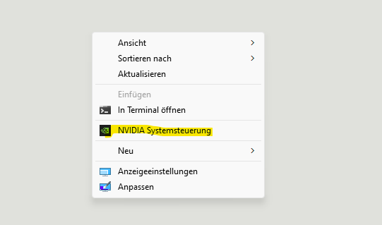

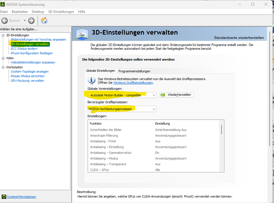

[Ma...] Posted January 30, 2025 Share Posted January 30, 2025 Hello Vishal, If you start CALYPSO without opening an Inspection, please check in the Task Manager if the Acis3x.exe is running: it might be hidden within the vwnt.exe If its not running it might be an IT issue, the Acis.exe sometimes gets blocked or deleted by firewalls or antivirus apps. Check the following path if you use CALYPS 7.8: C:\Program Files\Zeiss\CALYPSO 7.8\bin\acis If the Acis.exe is running please change the following settings in the NVIDIA System Settings: Regards Marcel Link to comment Share on other sites More sharing options...

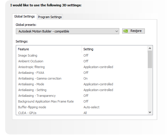

[Vi...] Posted January 31, 2025 Author Share Posted January 31, 2025 INVIDIA Global settings only one option is how in image 3D setting gINVIDIA Global settings only one option is how in image 3D setting Link to comment Share on other sites More sharing options...
