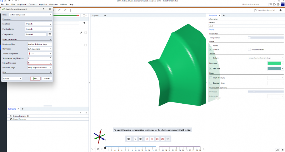

[Mo...] Posted February 3, 2025 Share Posted February 3, 2025 Dear Erencan, You can close the gaps in the surface component using the expert parameters before you create the surface component in the creation dialogue in the expert parameters or after creating it by clicking F4 on the generated surface component in the explorer as shown in the attached image. Usually, you can close the majority of the smaller holes with the sizes 1 to 2. With larger interpolation sizes, GOM recommends viewing the evaluated results critically. Here is the Tech-Guide Artikel :ZEISS Quality Tech Guide Best regards Mohamed Link to comment Share on other sites More sharing options...
[Th...] Posted February 5, 2025 Share Posted February 5, 2025 Hi Erencan, some additional thoughts: the method Mohammed mentioned is technically correct. But anyways, I would take a few steps beforehand, as 40% strain are typically no problem for correlate algorithms. Thus please check your image quality (lighting, sharpness, ...) and facet sizes according to your pattern (as a rule of thumb, there should be about "3-5 dots of black on white per facet")! You can also use a polygon to mask out your surface component in the image. This also increase the quality at the edges of your specimen (and also speeds up computation;-). If you would like to have some comments/recommendations, please feel free to post a screenshot of your creation of your surface component. Hope this helps. Best, Thorsten Link to comment Share on other sites More sharing options...
