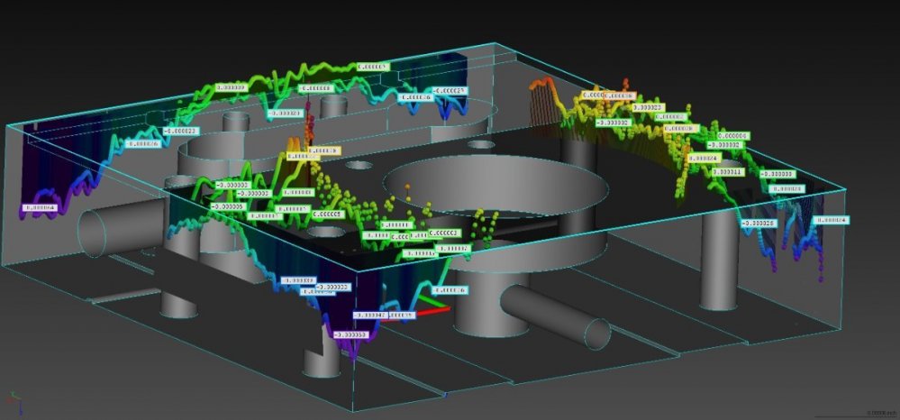

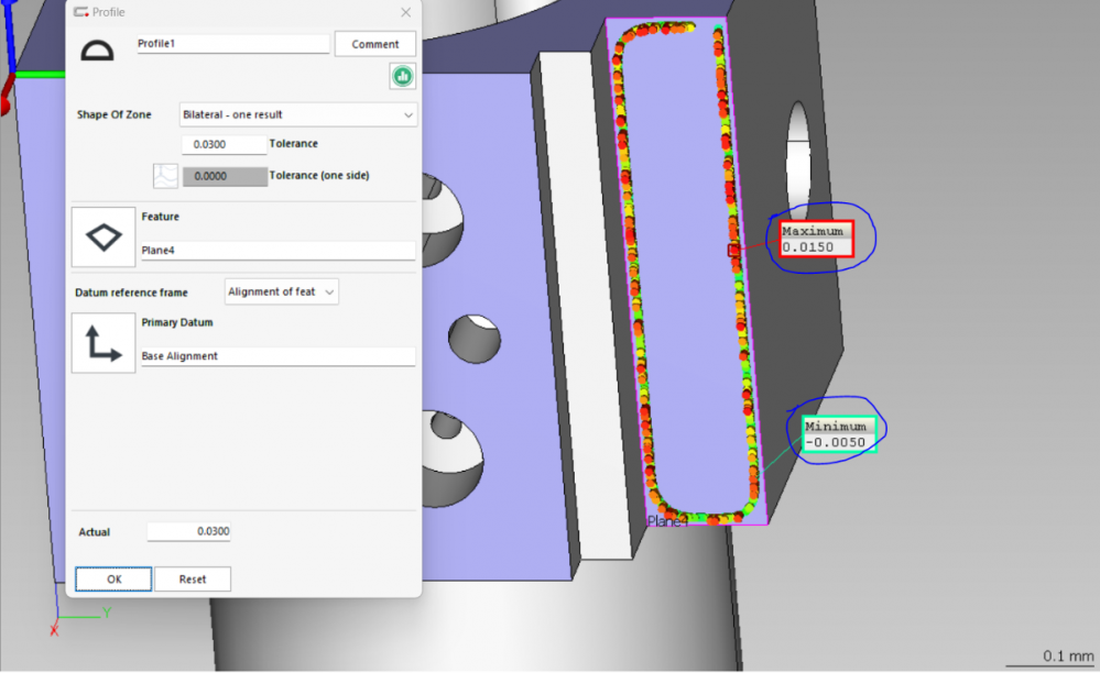

[Za...] Posted February 3, 2025 Share Posted February 3, 2025 Was going through the knowledge found a feature they showed in a screen shot (circled in blue) and would like to be able to copy it. Can someone please point me in the right direction, thanks. Link to comment Share on other sites More sharing options...

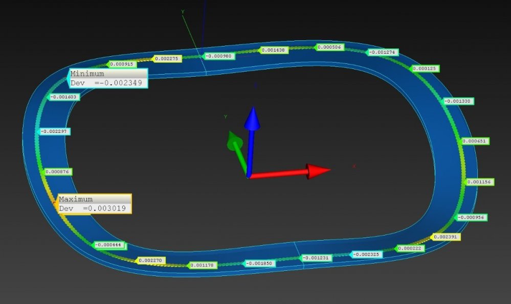

[Ma...] Posted February 3, 2025 Share Posted February 3, 2025 Select that characteristic and on menu CAD -> Evaluation turn on Min/Max points - it's on first page of window - if it's not there, then make any dummy callout ( for ex. circularity ) - it will show another options. I have sometimes with labels, sometimes without them. Link to comment Share on other sites More sharing options...
[Za...] Posted February 3, 2025 Author Share Posted February 3, 2025 (edited) Please sign in to view this quote. What year calypso are you on? Mine doesn't show that option. Edit - Spoke to soon didn't notice I didn't have the characteristic highlighted still. Thanks for the help. Edited February 3, 2025 Link to comment Share on other sites More sharing options...

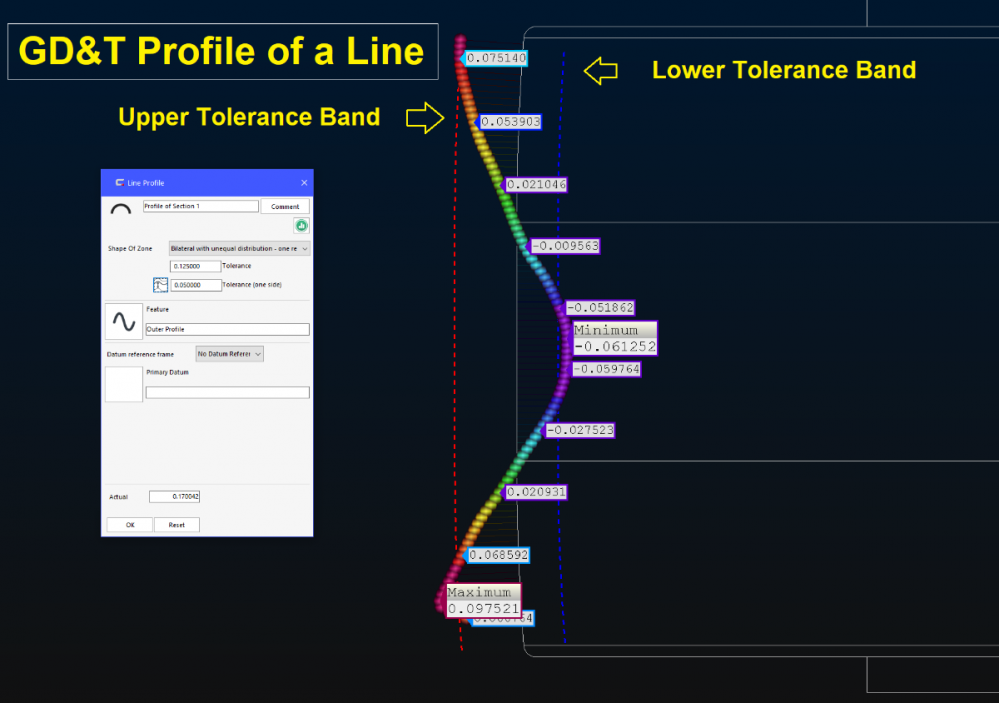

[Za...] Posted February 4, 2025 Share Posted February 4, 2025 There is a Knowledge Base article which goes in depth on allowing these sorts of banners to display. https://portal.zeiss.com/knowledge-base?id=882925 Link to comment Share on other sites More sharing options...
[Je...] Posted February 4, 2025 Share Posted February 4, 2025 Dream big. Graphical reporting is powerful, and Calypso does a decent job of facilitating this. Link to comment Share on other sites More sharing options...
