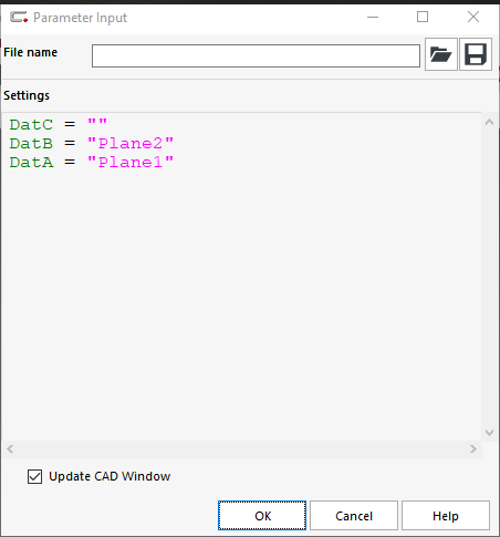

[Br...] Posted February 6, 2025 Share Posted February 6, 2025 I am trying to use variables to modify datums on a position characteristic. The characteristic will modify itself based on the requirement of the hole it is measuring. So If I had a position callout of .005 on datums -ABC-, it would update the tolerance and datums accordingly. My question is, how do you input nothing? If I want to assign a value of nothing to the variable, how would I go about doing that? If there is no tertiary datum, I just want to have it left blank. Does anyone know how I might go about doing this? Link to comment https://qualityforum.zeiss.com/topic/22326-need-some-pcm-assistance/ Share on other sites More sharing options...

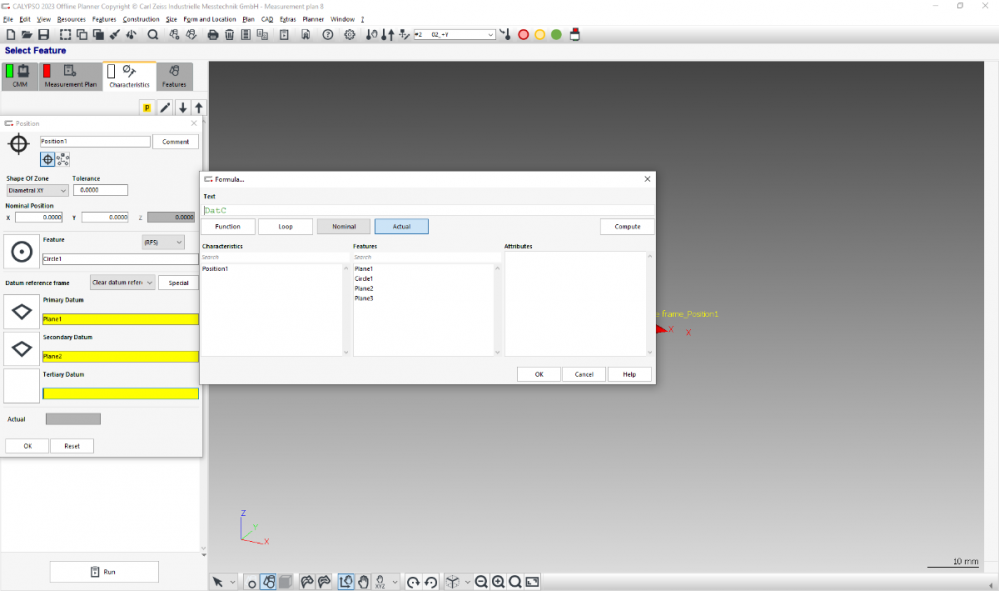

[Br...] Posted February 6, 2025 Author Share Posted February 6, 2025 For whatever reason when running simulation, leaving it blank in that way using just the "" causes the characteristic to fail. Link to comment https://qualityforum.zeiss.com/topic/22326-need-some-pcm-assistance/#findComment-125812 Share on other sites More sharing options...

[Mi...] Posted February 7, 2025 Share Posted February 7, 2025 (edited) Did you try: DATC="" // no reference or DATC="FeatureName" // reference element dummy="DATC" and in the position charateristic you put compute(dummy): Edited February 7, 2025 Link to comment https://qualityforum.zeiss.com/topic/22326-need-some-pcm-assistance/#findComment-125868 Share on other sites More sharing options...

[No...] Posted February 7, 2025 Share Posted February 7, 2025 The problem might be that Calypso thinks there is "something" in that field because it still points to a formula/variable (yellow background). But an empty variable is not necessarily the same as an empty field, since both may be processed on different "levels". Link to comment https://qualityforum.zeiss.com/topic/22326-need-some-pcm-assistance/#findComment-125886 Share on other sites More sharing options...

[Mi...] Posted February 7, 2025 Share Posted February 7, 2025 Please sign in to view this quote. Forget the post above! It doesn't work! The following worked at least in simulation: DATC="" // no reference //--------------------------------------- // if you have a reference element dummy="FeatureName" DATC="dummy" //--------------------------------------- in characteristic insert compute(DATC) per formula: Link to comment https://qualityforum.zeiss.com/topic/22326-need-some-pcm-assistance/#findComment-125892 Share on other sites More sharing options...
