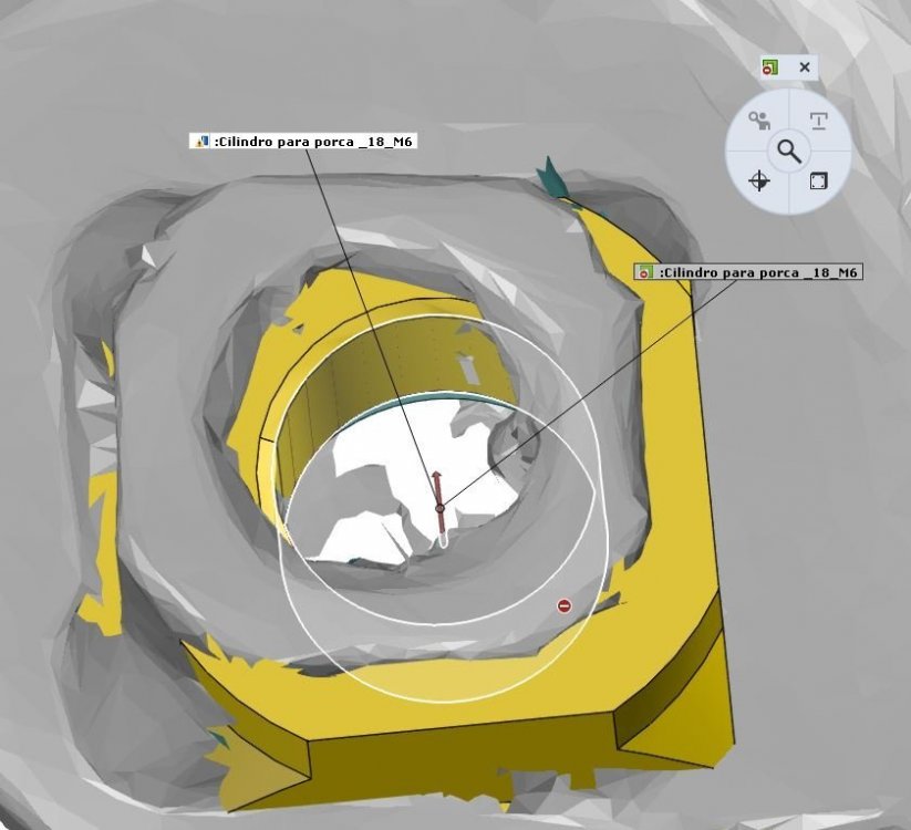

[Ed...] Posted February 7, 2025 Share Posted February 7, 2025 Hello, I need to fitting element for a nominal cilinder, but sometimes the mesh is far from the nominal and the software doesn't recognize it. I tried to change the parameter max distance, but when I disable "Compute Max distance automatically" it lose the link with nominal element. I can pick the cilinder by select the mesh region manually, but I don't know if it will lose the parametric. Link to comment Share on other sites More sharing options...
[Na...] Posted February 10, 2025 Share Posted February 10, 2025 Hello Eduardo, if the mesh is too far away you might want to create an alignment for the calculation of this element: https://techguide.zeiss.com/en/zeiss-inspect-2025/article/how_to_use_the_function_alignment_required.html The mesh data looks a bit noisy on your screenshot, so it might not help in this case but you have to try to improve the scan data. Nanno Link to comment Share on other sites More sharing options...
