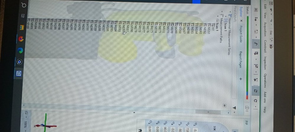

[Pa...] Posted February 12, 2025 Share Posted February 12, 2025 When trying to rerun a measurement routine that has 380 images, for some reason the measurement path starts at M262 rather than M1. How can I reorganize the measurement path so that it starts with M1 every time? I have attached a picture to show that for some reason 262 is where the measurement path starts. Link to comment Share on other sites More sharing options...
[Ma...] Posted February 28, 2025 Share Posted February 28, 2025 Paul, It looks like your measurement path optimized its pathing. I would not worry to much on sequence of the measurement positions so long as the path does not create a collision. Link to comment Share on other sites More sharing options...
