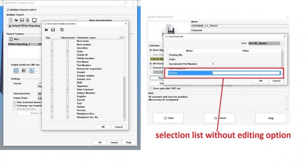

[Ma...] Posted February 18, 2025 Share Posted February 18, 2025 Hello! #Calypso 7.8: Do you know where can I add new variable with selection list without editing option? I remember that in previous version Calypso 7.4 I used option like this. In this version I cannot find this.. Link to comment Share on other sites More sharing options...

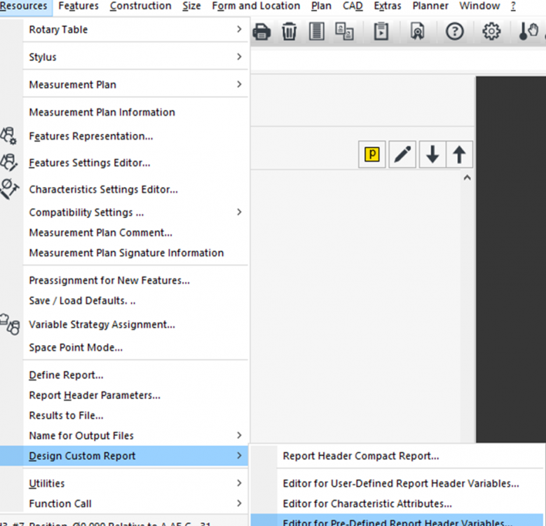

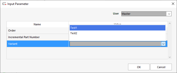

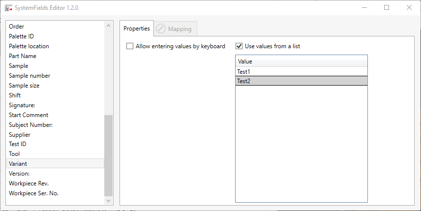

[Ri...] Posted February 18, 2025 Share Posted February 18, 2025 If this is your custom variable it is in Resources - Design Custom Report - Editor for User-Defined Report Header Variables If this is a pre-defined variable like Variant it is in Resources - Design Custom Report - Editor for Pre-Defined Report Header Variables Either one, just select the header field, turn off Allow entering values by keyboard, turn on Use values from a list, and define your list. Link to comment Share on other sites More sharing options...
[Ma...] Posted February 18, 2025 Author Share Posted February 18, 2025 This was very helpful for me. Thanks a lot! 🙂 Link to comment Share on other sites More sharing options...

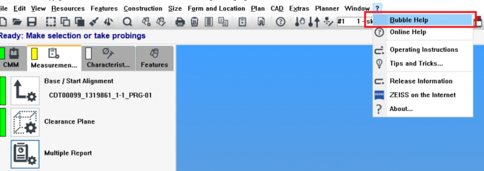

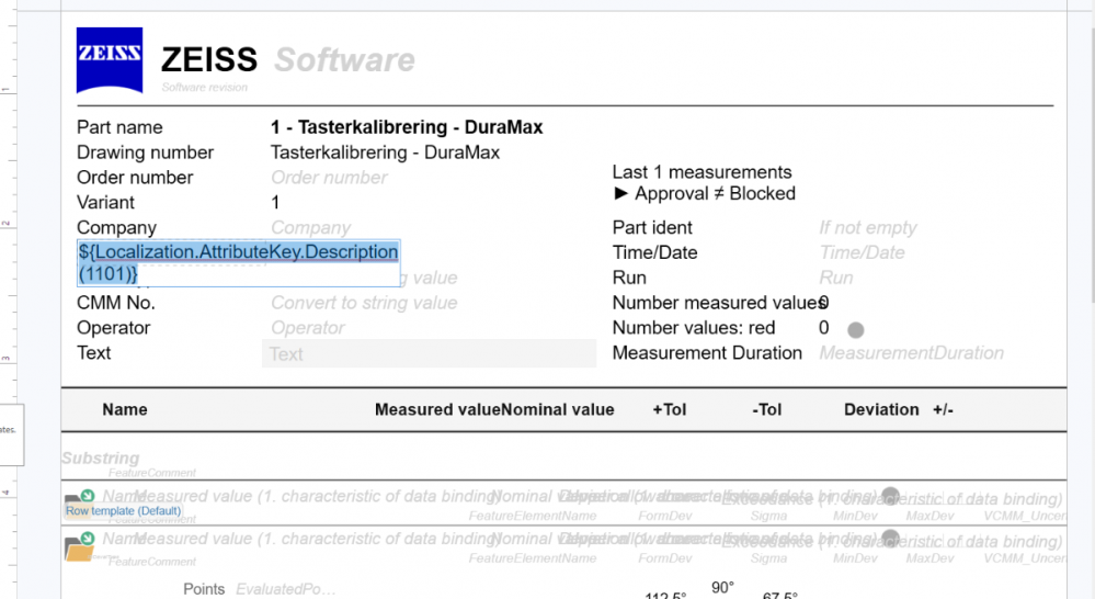

[Ma...] Posted February 18, 2025 Author Share Posted February 18, 2025 Please sign in to view this username. thanks for help. I did this according to your instructions and it works. Can you help me with one more thing? How can I add this new variable to the report in PiWeb? Link to comment Share on other sites More sharing options...
[Ma...] Posted February 18, 2025 Share Posted February 18, 2025 Look into the window with checkboxes ( your first post ) - last column is "?" - move your mouse pointer there ( leave mouse for a few seconds still ) to your needed row and it will show you what to write into PiWeb protocol. Link to comment Share on other sites More sharing options...
[Ma...] Posted February 21, 2025 Author Share Posted February 21, 2025 Please sign in to view this quote. I didn't have Bubble help activated, but when I activated it, your method works. Thanks 🙂 Link to comment Share on other sites More sharing options...
[Ma...] Posted February 21, 2025 Share Posted February 21, 2025 Please sign in to view this username. Thanks :-) I didn't know that is something you can alter ( turning it on and off ). Link to comment Share on other sites More sharing options...
