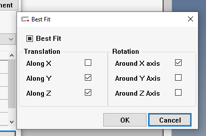

[Mi...] Posted February 19, 2025 Share Posted February 19, 2025 When setting up a Geometry Best-Fit or 3D Best fit... If I check off like the example below, am I saying " Allow Translation along Y and Z, and Allow Rotation around the X Axis" or am I saying " Do not allow Translation along Y and Z, and Do not allow Rotation around the X Axis" The various wordings could be interpreted both ways. I'm reasonably certain the ones checked are the ones allowed... but I'm curious. Link to comment Share on other sites More sharing options...
[Ca...] Posted February 19, 2025 Share Posted February 19, 2025 You are correct! If you check the box, you're allowing that action. It is definitely confusing, don't feel bad about asking, I'm sure many have the same question, but you are correct! Link to comment Share on other sites More sharing options...
