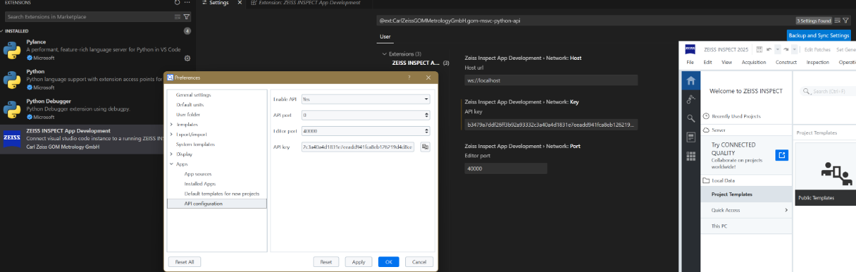

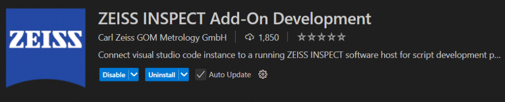

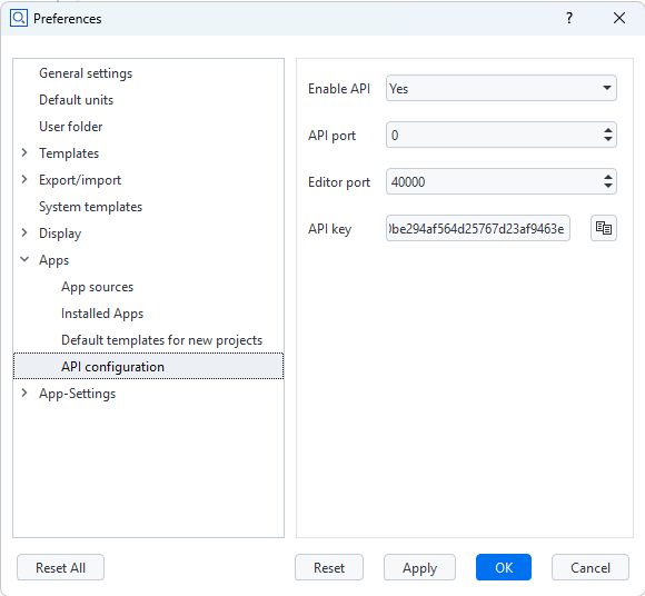

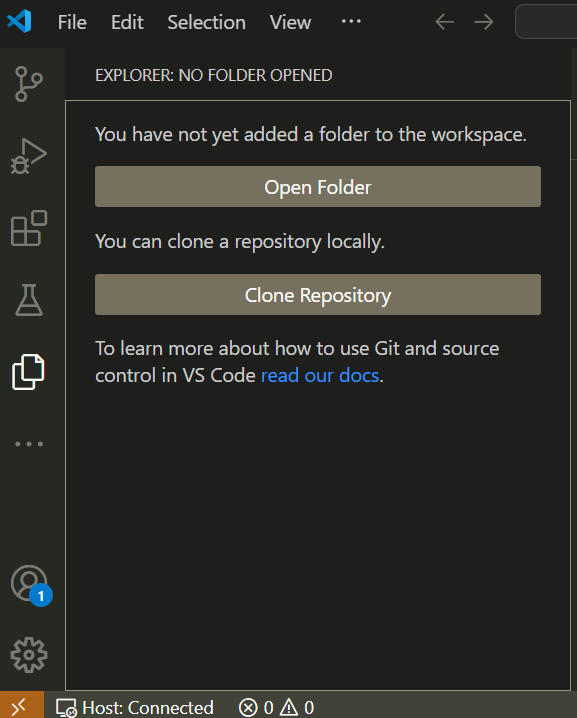

[Va...] Posted February 20, 2025 Share Posted February 20, 2025 Hello everyone, I have recently started to get into scripting in ZEISS INSPECT 2025 but using the internal editor is really holding me back, so i tried to connect vscode using this guide: Using Visual Studio Code as an add-on editor — Add-On Documentation However, when clicking on "Host: Disconnected" the only thing that happens is it tries to add a nonexisting folder to the workspace and doesn't connect. When I change the Editor Port in INSPECT to something else, vscode gives me an error saying "Cannot connect to application" so i know that the settings are correct. The settings in INSPECT also look a little different from the Guide, as they are under Apps->API configuration and there appears to be an API key which is not mentioned anywhere else. Link to comment Share on other sites More sharing options...
[An...] Posted February 21, 2025 Share Posted February 21, 2025 Do you have the "ZEISS INSPECT Add-on Development" installed in VSC? Link to comment Share on other sites More sharing options...
[Va...] Posted February 21, 2025 Author Share Posted February 21, 2025 Yes, without it there wouldn't be a "Host: disconnected" Button. I have also tried multiple versions of this addon. Link to comment Share on other sites More sharing options...
[An...] Posted February 21, 2025 Share Posted February 21, 2025 I have now also tested this with INSPECT 2025 - and also get no connection from VSC to INSPECT! With the INSPECT 2023 version, on the other hand, this works perfectly. I set the port to the same value 40000 in both versions. Link to comment Share on other sites More sharing options...
[Na...] Posted February 21, 2025 Share Posted February 21, 2025 Hello, this is being updated and will be possible again with INSPECT 2025 Service Pack 1 - release is not too far away. The documentation will be available at the same direction but for 2025: https://zeissiqs.github.io/zeiss-inspect-addon-api/2025/howtos/using_vscode_editor/using_vscode_editor.html Nanno Link to comment Share on other sites More sharing options...

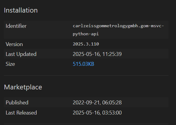

[Ma...] Posted May 16, 2025 Share Posted May 16, 2025 Hello, an update of the VSCode extension "ZEISS INSPECT App Development" has been released on ZEISS INSPECT App Development - Visual Studio Marketplace. Please see Using Visual Studio Code as App editor — App Development Documentation for setup and usage. Users of ZEISS INSPECT 2023 or earlier still have to keep using the VSCode extension version 2024.x.y. Best regards, Matthias Link to comment Share on other sites More sharing options...

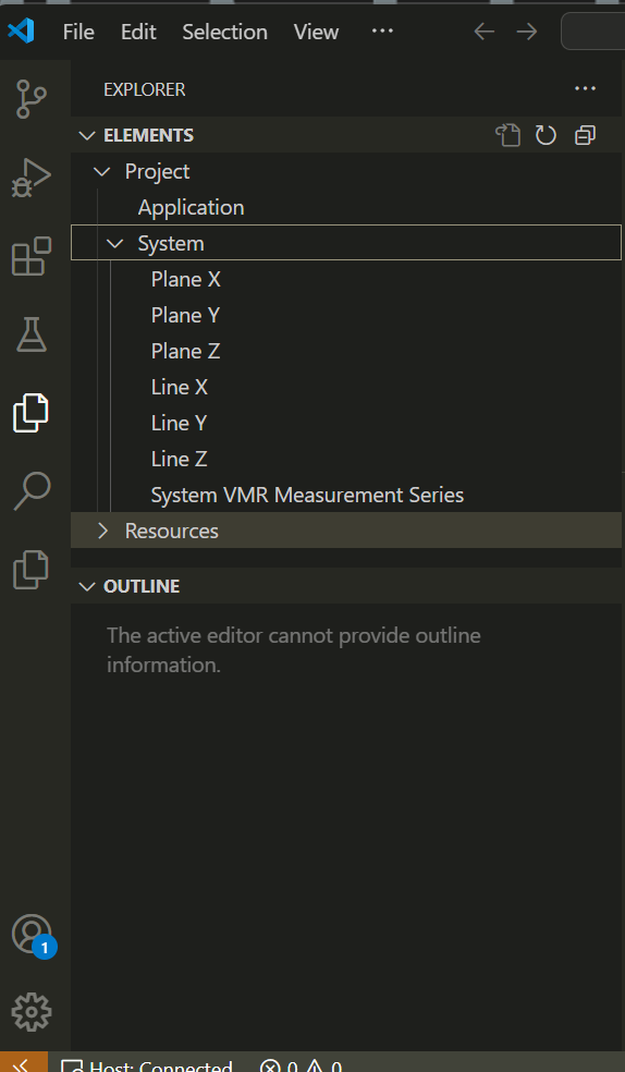

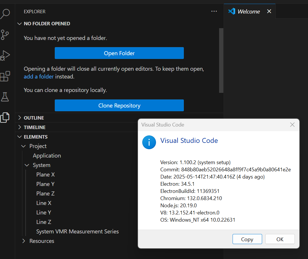

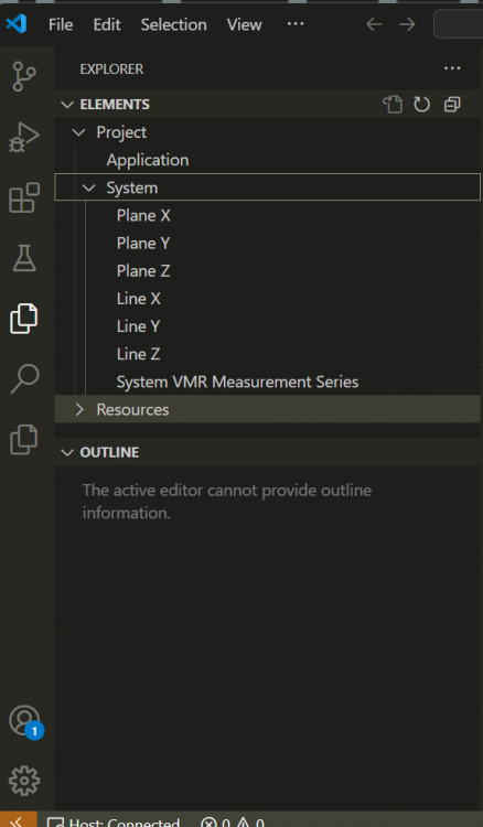

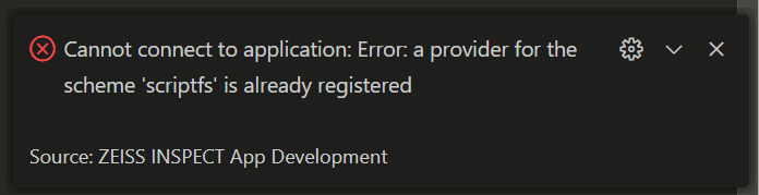

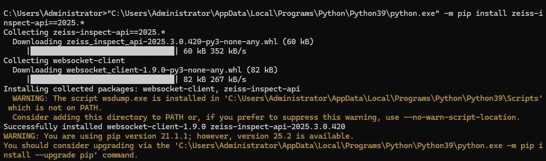

[De...] Posted May 16, 2025 Share Posted May 16, 2025 Thanks Matthias, I've followed the instructions, installed python 3.9, zeiss-inspect-api via pip, updated VScode extension to 2025.3.110, configured settings, choose 3.9 as python interpreter, & was able to connect, but its not loading any add-ons / workspaces into the explorer as it did in 2023: So although i'm 'connected' I see: but I am connected & see all the elements in the zeiss inspect 2025 (blank)project: disconnecting/reconnecting throws an error in bottom right comer: "Cannot Connect to Application: Error: a provider for the scheme 'scriptfs' is already registered' Not sure if its related, or just because I disconnected/reconnected. (it doesn't appear on initial connection) I tried uninstalling the zeiss inspect pluggin for vs-code, re-installing, restarting computer...etc. no luck. then I tried un-installing vs-code, deleting %APPDATA%\Code & %USERPROFILE%\.vscode then re-installing visual studio code / zeiss plugin, but still no luck. Any idea on what could be causing this? Link to comment Share on other sites More sharing options...
[Ma...] Posted May 19, 2025 Share Posted May 19, 2025 Hi Devon, which VSCode version are you using? Could you please re-check that the API port and the editor port numbers configured in ZEISS INSPECT and in the VSCode extension are matching? Best regards, Matthias Link to comment Share on other sites More sharing options...

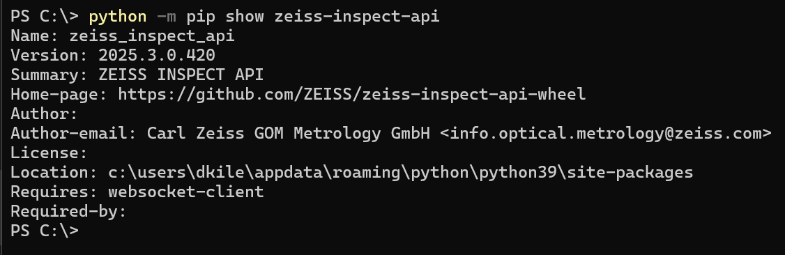

[De...] Posted May 19, 2025 Share Posted May 19, 2025 Hey Matthais, thanks for the quick response Visual studio code is v 1.100.2 Zeiss Inspect extension 2025.3.110 zeiss-inspect-api v2025.3.0.420 zeiss inspect v2025.1.0.1985 Port on extension & Zeiss Inspect = default 40000 tried changing it (30000) - no luck. let me know if a support ticket would be more appropriate. Thanks as always for your help! Link to comment Share on other sites More sharing options...
[Ma...] Posted May 20, 2025 Share Posted May 20, 2025 Hi Devon, thank you for the detailed information. I think you need at least ZEISS INSPECT 2025 Service Pack 1, i.e. 2025.2.x Could you please try to update? Everything else looks fine. Best regards, Matthias Link to comment Share on other sites More sharing options...
[De...] Posted May 21, 2025 Share Posted May 21, 2025 Ah, damn! I thought 2025.1 meant Service pack 1, my bad. installed 2025.2, works like a charm! thank you!!! Link to comment Share on other sites More sharing options...

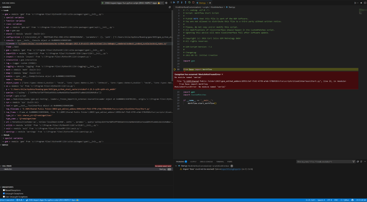

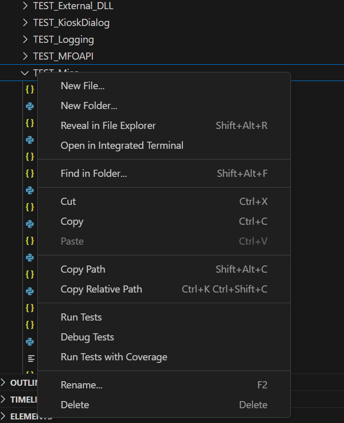

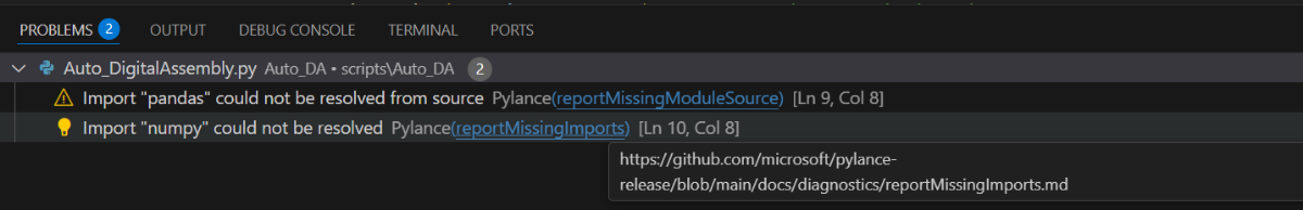

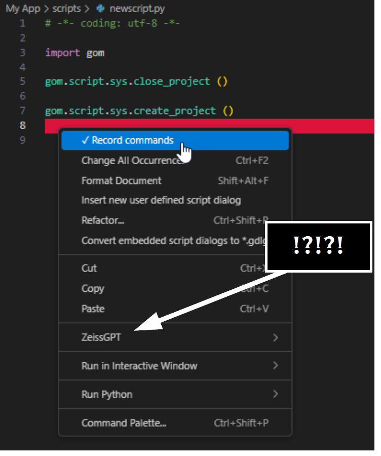

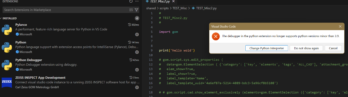

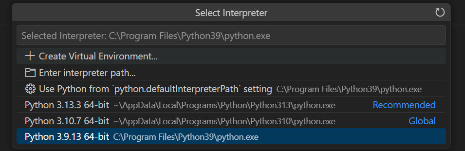

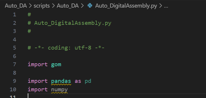

[De...] Posted May 23, 2025 Share Posted May 23, 2025 Hey Matthias, few questions for you: I was able to get connected & see apps both in locked/edit mode, but when I try to run a script I get this error: 1. should I ignore / do not show again? (..still seems to execute / debug just fine). 1.b - do we need to use python 3.9? or can I use a 3.10 - 3.13 ? 2. prior to script execution I get an error/warning: but it seems to import ok during runtime. 2. anyway to fix this? disable pylance? most important: 3. when I try to run kiosk mode through the 'start' in kioskmode(customizations) I get this error: is that because its trying to import workflow from the system scripts (which aren't in edit mode?) anyway to fix this? 4. to create a new gom script in vscode, do I just choose New File? i'm looking for the 'create gom script' equivalent that we had in the old version/2023. Side question 5.(highest importance = ) where do I get this!? I've been going through v2025 Kisok Mode's 5,000 lines of python code trying to trace references and dependencies with documentation from 2018 & the built in, 1 window .add on editor. ZeissGPT would be a godsend. 😃 sorry for the headache, and thanks for all your help, hopefully this post helps someone else who's having similar issues. Link to comment Share on other sites More sharing options...
[Ma...] Posted May 26, 2025 Share Posted May 26, 2025 Hi Devon, Just a quick answer to parts of your questions: 4. Yes, you can use "New File..." to add a Python script to your App. A special VSCode command is no longer needed. The new file might not be visible in the ZEISS INSPECT built-in App Explorer immediately. In this case, you can run the command gom.script.sys.update_addon_database() from an App. 5. ZeissGPT is a ZEISS internal extension, which is not related to the ZEISS INSPECT extension. Maybe you can use GitHub Copilot? I will come back to the remaining question soon. Best regards, Matthias Link to comment Share on other sites More sharing options...
[ca...] Posted May 29, 2025 Share Posted May 29, 2025 Hello all, I also encountered a problem when trying to use VSCode with 2025 software. I got module not found errors for already installed python packages like tkinter etc. which are installed in my specific apps created in 2023 version. I am not sure whether the problem arises due to migrating add-on packages from 2023 software or VS-Code related. Many Thanks, Canset Link to comment Share on other sites More sharing options...
[Ma...] Posted June 4, 2025 Share Posted June 4, 2025 Hi Canset, we are checking this. In the meantime - as a potential workaround - can you try to install the same packages you are using in your Apps (which are already installed using the ZEISS INSPECT App Explorer) in the external Python 3.9 environment, too? Best regards, Matthias Link to comment Share on other sites More sharing options...

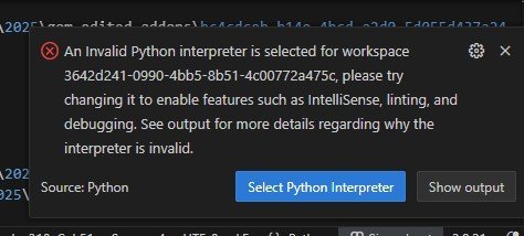

[ca...] Posted October 24, 2025 Share Posted October 24, 2025 Hello everyone, I still not be able to use VSCode with ZEISS Inspect 2025. VSCode does not let me change the python interpreter after connecting to the host. Please check the error messages I received. Thanks, Canset Link to comment Share on other sites More sharing options...
[Ma...] Posted October 24, 2025 Share Posted October 24, 2025 Have you allowed API? Link to comment Share on other sites More sharing options...

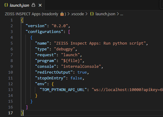

[ca...] Posted October 24, 2025 Share Posted October 24, 2025 Hello Martin, Yes, I have already enabled the API and followed the steps mentioned in the documentation. When I try to run the Python file or run the Python file in the dedicated terminal, it does not work. The 'Python Debugger: Debug Python File' option also does not work. But it just does not recognize the Python packages already available in ZEISS INSPECT. However, debugging using launch.json works perfectly. I did not quite understand the issue. Thanks, Canset Link to comment Share on other sites More sharing options...

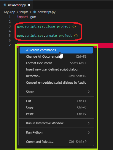

[Ma...] Posted October 24, 2025 Share Posted October 24, 2025 I have found something, but right now i have no time to inspect it - at home i have same problem - seems like wrong port Presented screens on git is nothing close to what i am seeing Not green ".script..." - no context menu and so on Link to comment Share on other sites More sharing options...
