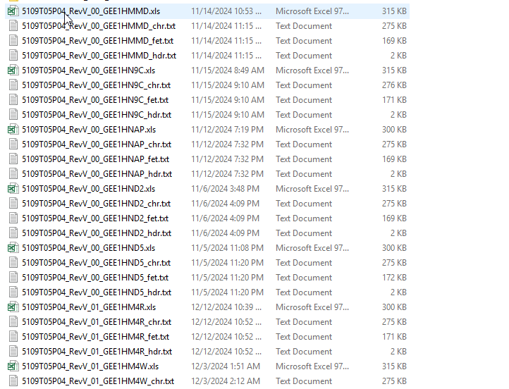

[Pa...] Posted February 20, 2025 Share Posted February 20, 2025 (edited) As I play with various settings here, it looks like GeoActuals and Excel outputs are both "result files" when I look at Extras/Settings/Environment/Paths. I must keep GeoActuals in a folder local to the CMM because we occasionally run the same program on more than one CMM simultaneously. Boss wants Excel outputs out on the network where anyone can grab them. I do use Resources/Results to File and Resources/Name for output files to manage measured points and PDF reporting. In these windows there are a bunch of options for file types; none of them is "Excel" or "GeoActuals". While it is always cool and fun to figure out how many different names Zeiss and Calypso can come up with for one thing, I'm not enjoying it today. Can anyone give me an easy button here? I want excels to go down one path and the GeoActuals down another. Which five windows do I need to click through in what order? Edited February 20, 2025 Link to comment https://qualityforum.zeiss.com/topic/22506-paths-excel-report/ Share on other sites More sharing options...

[Pa...] Posted February 20, 2025 Author Share Posted February 20, 2025 Thanks. I have all of this. I am generating the Excel properly. What I have clearly asked is how to get GeoActuals and Excel reports to go to different places. See the screenshot. I want these .xls files in one network folder and all of the .txt files in a local folder. My internal customers need unrestricted access to the .xls while all of the .txt files must be on a local drive so I can run the program in multiple machines. Link to comment https://qualityforum.zeiss.com/topic/22506-paths-excel-report/#findComment-126874 Share on other sites More sharing options...
[To...] Posted February 20, 2025 Share Posted February 20, 2025 (edited) Please sign in to view this quote. I don't believe there is a way in Calypso to send the "real" excel spreadsheet to a different location. Maybe in PiWeb? You will hear things like, export table files and set the name for output files of the characteristics table file to have an .xls file ending but that is only a formatted text file that opens in excel. In other words, the 2nd file in your list would be the same exact file except it would end with .xls Edited February 20, 2025 Link to comment https://qualityforum.zeiss.com/topic/22506-paths-excel-report/#findComment-126876 Share on other sites More sharing options...

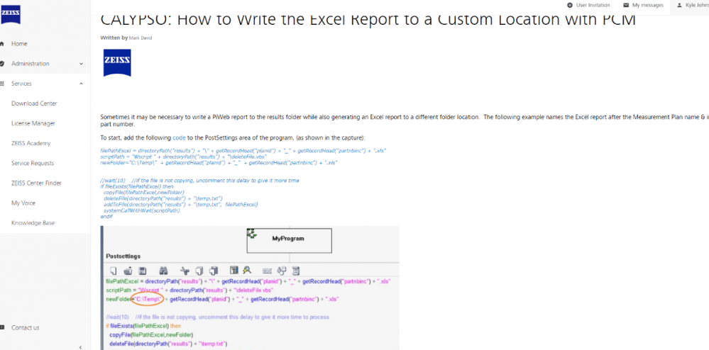

[Cl...] Posted February 20, 2025 Share Posted February 20, 2025 (edited) Do you have PCM? If so, I can get you there part of the way. You can sent variable data in the form of a .csv file to a seperate location. It won't be the same format as the Zeiss characteristic spreadsheet. I don't know what the pressettings for this would be. You'd have to get additional help from a PCM expert to add some minor details. Postsettings: /Dims to Excel filePath = "M:\Measurement Equipment Results\Zeiss Calypso\O-inspect\"+OD+"\" ext = ".csv" Edited February 20, 2025 Link to comment https://qualityforum.zeiss.com/topic/22506-paths-excel-report/#findComment-126880 Share on other sites More sharing options...

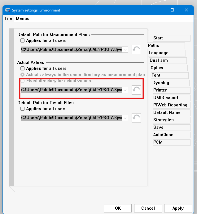

[Ky...] Posted February 20, 2025 Share Posted February 20, 2025 Unfortunately the only way to move the Excel report from the default results location is through either a batch file or a PCM file that will move it after the creation. If you do have PCM, this article in our knowledge base should help, but if you are familiar with coding, it should also help you if you need to make a batch file. https://portal.zeiss.com/knowledge-base?id=722231. Incidentally, you can change the location of the geoactuals separately. That would be under extras>settings>environment in the paths window. You want to set the Actual files to be always be in the fixed directory (which is on your C drive). Note the image above is grayed out because I was in a program when I made the screenshot. I hope you find this useful. Link to comment https://qualityforum.zeiss.com/topic/22506-paths-excel-report/#findComment-126904 Share on other sites More sharing options...

[Ja...] Posted February 25, 2025 Share Posted February 25, 2025 You can use a .bat file to move the excel file to where ever you want it. It executes at the end of each run. See attachment save excel report.pdf Link to comment https://qualityforum.zeiss.com/topic/22506-paths-excel-report/#findComment-127168 Share on other sites More sharing options...
[ni...] Posted February 25, 2025 Share Posted February 25, 2025 Please sign in to view this quote. Martin, That's works, thanks a lot. Link to comment https://qualityforum.zeiss.com/topic/22506-paths-excel-report/#findComment-127196 Share on other sites More sharing options...
