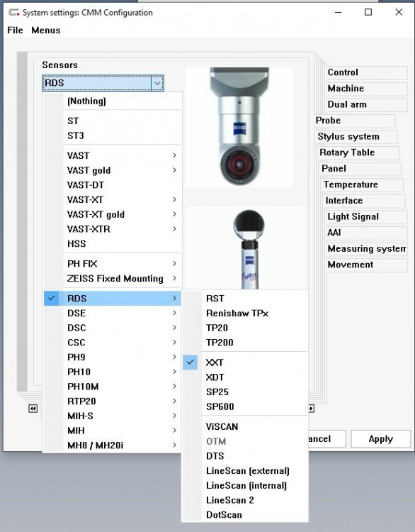

[Ri...] Posted February 20, 2025 Share Posted February 20, 2025 I can't seem to find the RDS Head where the RDS Holder is mounted in Stylus System Creator so I can create rotations around A and B axis. I thought it was available at one time. Link to comment Share on other sites More sharing options...
[To...] Posted February 20, 2025 Share Posted February 20, 2025 There is probably a Knowledge Base article somewhere....😁 Just preparing you for the obvious. Link to comment Share on other sites More sharing options...
[Th...] Posted February 20, 2025 Share Posted February 20, 2025 The head isn't part of SSC. It's modeled as part of the machine's Z mast in Calypso itself, so it shows up when you're using simulation. As for Tom's prediction of a KB article, well... Link to comment Share on other sites More sharing options...
[Ri...] Posted February 20, 2025 Author Share Posted February 20, 2025 Please sign in to view this quote. Yea, I found that article easily when Tom made the suggestion. I was hoping to do this all via Stylus System Creator, but that won't allow rotation around A (Only B). Link to comment Share on other sites More sharing options...

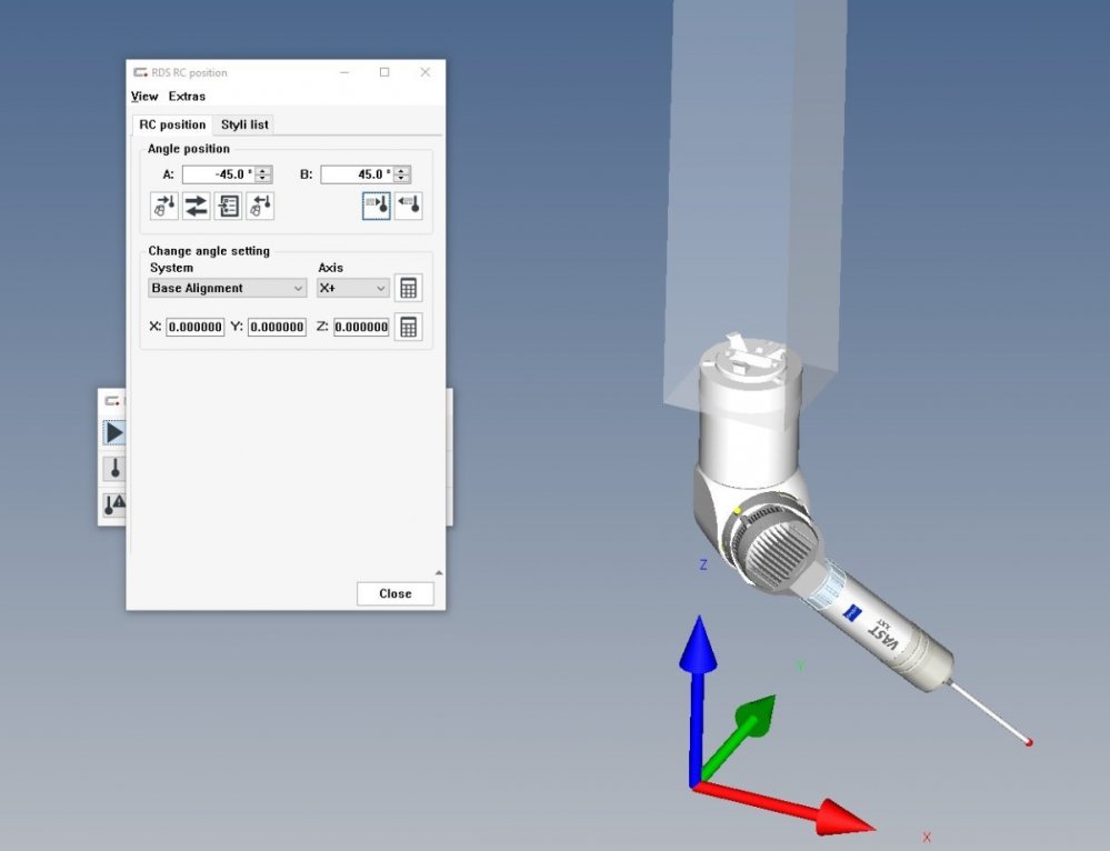

[To...] Posted February 20, 2025 Share Posted February 20, 2025 (edited) Please sign in to view this quote. Do you mean like this? Edited February 20, 2025 Link to comment Share on other sites More sharing options...
[Ri...] Posted February 21, 2025 Author Share Posted February 21, 2025 Planner displays it correctly, but SSC doesn't. Yes, just like that, but in planner would be nice. Link to comment Share on other sites More sharing options...
[To...] Posted February 21, 2025 Share Posted February 21, 2025 (edited) Please sign in to view this quote. What? Planner displays it correctly..........but in planner would be nice. My screenshot was from Planner Edited February 21, 2025 Link to comment Share on other sites More sharing options...
[Ri...] Posted February 21, 2025 Author Share Posted February 21, 2025 That was supposed to say: Yes, just like that, but in SSC would be nice. 🤣 Link to comment Share on other sites More sharing options...
