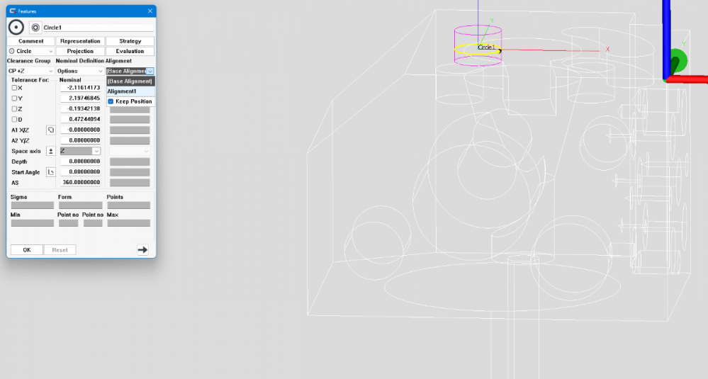

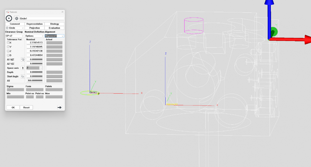

[Ky...] Posted February 20, 2025 Share Posted February 20, 2025 If there is like a consistent offset for them (like say everything needs to move 20 mm in +X and 50 in the -Y), you can set up a secondary alignment that incorporates that offset and in the feature you can go to the alignment dropdown and select "keep position" and then change the alignment. You'll notice that the X, Y, Z values have not changed but the physical location of the feature has since it is in a new alignment. From here you can turn off the "keep position" checkmark and then go back to the base alignment (if you want). Unfortunately, there isn't really a way for effectively random changes in multiple features (1 moving in 1 direction and another in a different way). I hope this is helpful. Link to comment https://qualityforum.zeiss.com/topic/22516-move-features-to-new-position/#findComment-126906 Share on other sites More sharing options...
