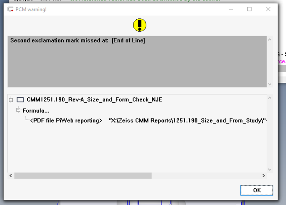

[Na...] Posted February 21 Share Posted February 21 I am trying to have my program auto save the reports and number per run. When the file saves it has "1251.190_Size_and_Form_Study+getRecHdForFil(partnbinc)+.pdf" on the end of the save rather than the number. Also i get this message when the program ends. This is what I have on the name definition for the saved pdf. "X:\Zeiss CMM Reports\1251.190_Size_and_From_Study\"+"1251"_"190"_"Size"_and_Form"_"Study"+getRecordHead("partnbinc")".pdf" We do not have the PCM license active. Link to comment Share on other sites More sharing options...
[Na...] Posted February 21 Author Share Posted February 21 Nevermind, I didn't add an underscore after the study and now it's working as expected. Link to comment Share on other sites More sharing options...
