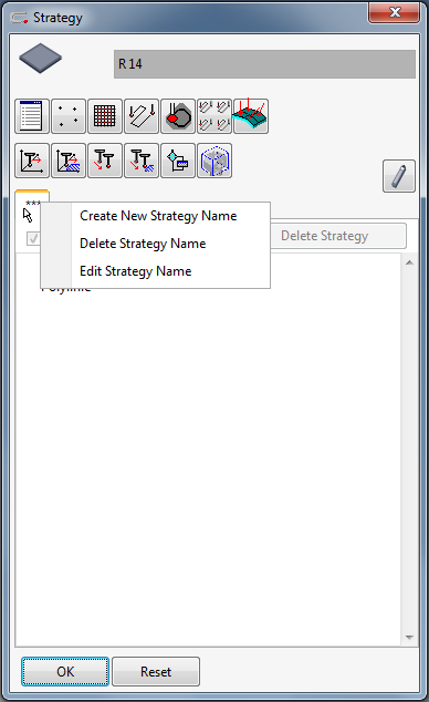

If you need to adjust speeds and probes, then defining new strategy is only option ( instead of duplicating program )

Martin, what prompts Calypso to use one strategy over another? I'm curious if there is a parameter that would allow you to select different machine numbers and utilize the given strategy based on that.
It should be selectable in start parameters ( same like characteristic selection or maximum speed ).
