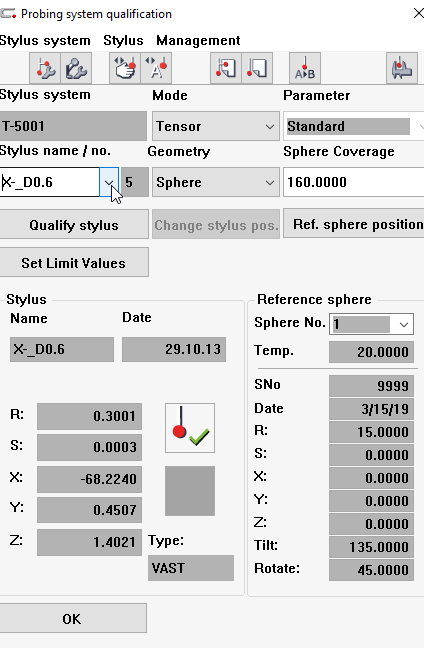

[Ch...] Posted February 26, 2025 Share Posted February 26, 2025 Hi Luis, for smal Radius Probes we change the sphere coverage(angle) maybe 90°-100°, also the probing force an dynamic. Link to comment Share on other sites More sharing options...
[DW...] Posted February 26, 2025 Share Posted February 26, 2025 Please sign in to view this quote. Please sign in to view this username. You are going to need the Zeiss 8mm sphere to do 180° coverage on a 0.5mm probe. Please sign in to view this username. is correct you can decrease the coverage, which may work in your situation. Also do you have the original certificate for the 16mm sphere indicating its actual size? If you do not know its actual size, placing "8mm" in the reference sphere management sphere radius is going to give you trouble with accurate measurements. Link to comment Share on other sites More sharing options...
[Mi...] Posted February 26, 2025 Share Posted February 26, 2025 Decreasing the coverage only works on XT machines FYI, XXT will always scan half the ball. Depending on the machine you have, I'm not sure the 16mm ball will work. I bought an 8mm ball for this same job type. How much time did I waste on that in the early days.... Link to comment Share on other sites More sharing options...

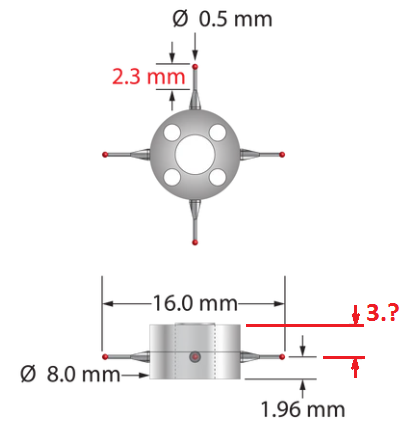

[To...] Posted February 26, 2025 Share Posted February 26, 2025 An 8mm reference sphere may not work. The distance from tip to tip is 16, meaning the distance from center to center is 16-0.5 or 15.5. The diameter of the hub is 8mm which means the distance from the center of one tip to the hub is 3.5. This means the hub could potentially hit the sphere when the probe is at the equator of the ref sphere. I created pic below for another application but it shows the issue I'm trying to explain Link to comment Share on other sites More sharing options...

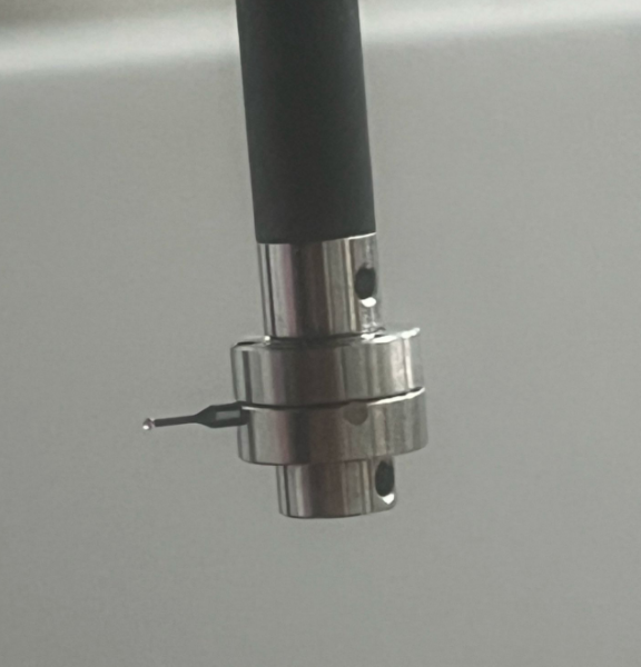

[Da...] Posted February 26, 2025 Share Posted February 26, 2025 I use a 6mm probe as a reference sphere and it works well. Link to comment Share on other sites More sharing options...
[na...] Posted February 26, 2025 Share Posted February 26, 2025 Please sign in to view this quote. How do you mount it, can you share a picture? Link to comment Share on other sites More sharing options...
[Ma...] Posted February 27, 2025 Share Posted February 27, 2025 It could be calculated, but missing crucial dimension ( missing dimension: 3.? ) Link to comment Share on other sites More sharing options...
