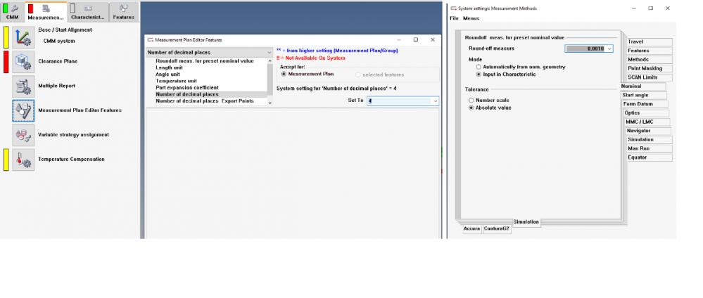

[Ja...] Posted February 27, 2025 Share Posted February 27, 2025 Hello all, Quick question, is there a way to output results with the use of rounding to three decimal places only? Our customer only is interested in values to this extent and we are attempting to provide reports to satisfy this requirement. We have revised our Calypso program to only display values to three places, but since there is an issue at the fourth or fifth decimal place, it is reported as out of tolerance. Ex. S/B: 10.000 +/- .005 dimension. Is: 10.005002 This result will then show up as red on our PiWeb report. Using Calypso 2022, ServicePack 1. Thanks for any assistance provided, James Canham Link to comment Share on other sites More sharing options...

[Ca...] Posted February 28, 2025 Share Posted February 28, 2025 Unfortunately, that doesn't help. Fewer digits are then displayed, but if there is a value of e.g. 1.052mm on the 4th digit and the tolerance is +-0.05, a red deviation is still displayed in the report. I've been looking for a solution for a while. Calypso doesn't round, it simply cuts off the last digits on the report. Link to comment Share on other sites More sharing options...

[To...] Posted February 28, 2025 Share Posted February 28, 2025 (edited) Please sign in to view this quote. There is another post with the same title that may help your situation. Edited February 28, 2025 Link to comment Share on other sites More sharing options...
