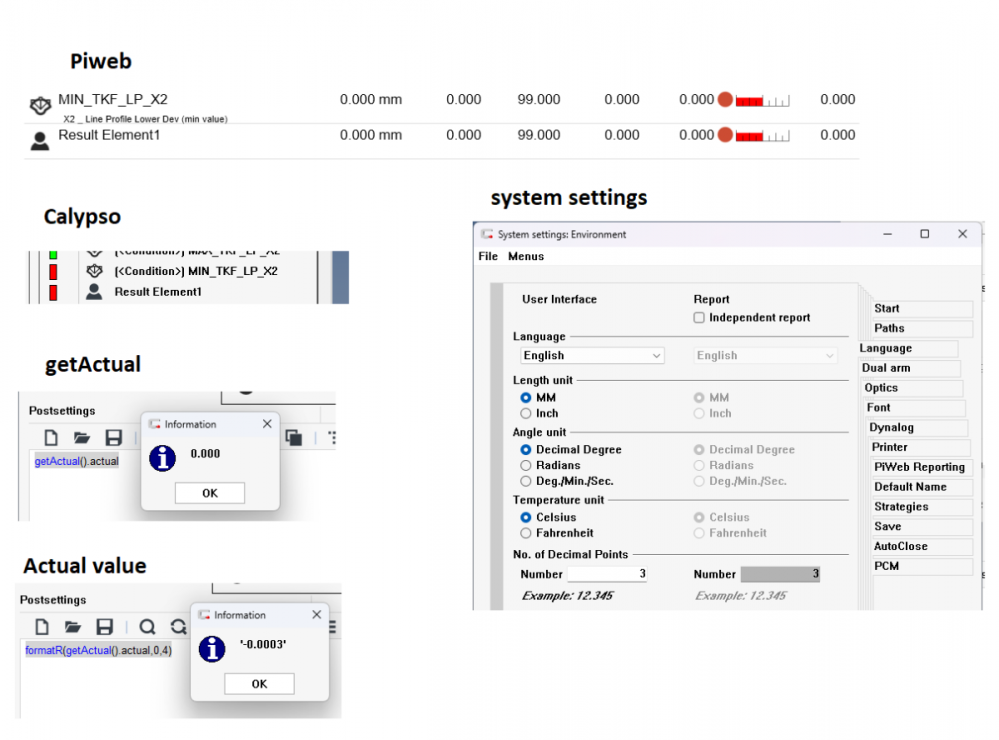

[I...] Posted April 10, 2025 Share Posted April 10, 2025 what about this ? (the tolerance is in mm) is it correct to reject my part?, or i need to round any single characteristic because the software is not able to do it automatically? Link to comment https://qualityforum.zeiss.com/topic/22597-calypso-report-for-customer/#findComment-129987 Share on other sites More sharing options...
[To...] Posted April 10, 2025 Share Posted April 10, 2025 (edited) In ASME, the part is out of tolerance, regardless of how many decimal places. Edited April 10, 2025 Link to comment https://qualityforum.zeiss.com/topic/22597-calypso-report-for-customer/#findComment-130001 Share on other sites More sharing options...
