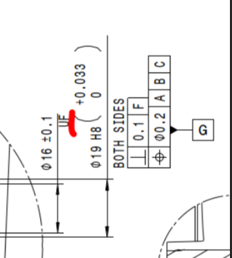

[En...] Posted February 28, 2025 Share Posted February 28, 2025 Buongiorno vorrei capire come calcolare il diametro con il simbolo UF ... sembra strano ma sul disegno c'è il simbolo su un diametro Ringrazio in anticipo Enzo Link to comment Share on other sites More sharing options...
[Ma...] Posted February 28, 2025 Share Posted February 28, 2025 It should be United feature https://www.eng-tips.com/threads/uf-and-collection-planes-in-iso-gps.519963/ Link to comment Share on other sites More sharing options...
[En...] Posted February 28, 2025 Author Share Posted February 28, 2025 Thanks Martin And if I wanted to measure it Link to comment Share on other sites More sharing options...

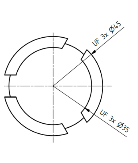

[Ma...] Posted February 28, 2025 Share Posted February 28, 2025 I am not sure if that UF is for dia16 or 19H8 - is any of that cylinder interrupted by slot or empty space? Right now i am not sure if UF and CZ are similar. Here is something what we have here - it should act like one clinder ( dia45 ) and one cylinder ( dia35 ) and not like 3x cylinder dia45 ... Link to comment Share on other sites More sharing options...
