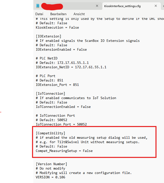

[Ro...] Posted February 28, 2025 Share Posted February 28, 2025 Hello, Im using a Scanport in kiosk mode with a reference frame. Is there any possibility to add a pauze in the measurement to flip the part between scan 1 and scan 2? Link to comment Share on other sites More sharing options...
[Ju...] Posted March 7, 2025 Share Posted March 7, 2025 Hi, setting the marked parameter in your KioskInterface_settings.cfg file to 'True' should help. There is also an useful free App called 'Measuring Setup Tools' to integrate a short description and picture of the setup. Best regards, Julian Link to comment Share on other sites More sharing options...
