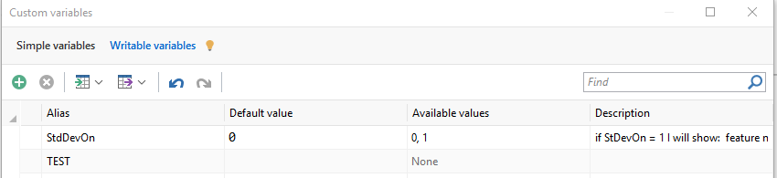

The closest that I have been able to determine is the following method:
  1. Create a custom writable variable by navigating to File -> Custom Variables. Click on Writable variables. I have created an example writable variable named TEST.

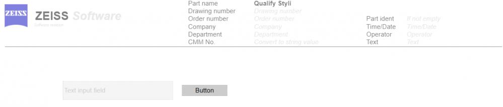

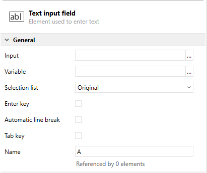

  2. Add a Text Input Field and a Button onto your report.
  3. In the properties of the Text Input Field, enter a name for the text box in the Name property. I entered the name "A"

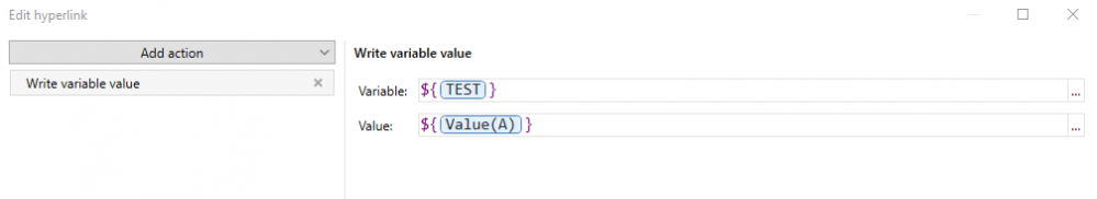

  4. In the properties of the Button, click the hyperlink button. Add the Write variable value action. Enter ${CUSTOM_VARIBLE} to the Variable Field, where CUSTOM_VARIBLE is the name of the custom variable you created. Enter ${(Value("NAME"))} to the Value field, where NAME is the name of the text input field that you created.

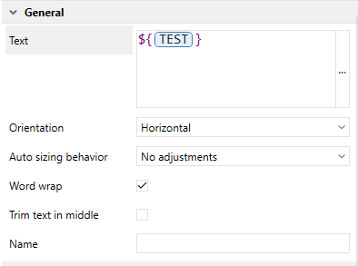

  5. On a new page, add a text box. In the properties of the text box add the text ${CUSTOM_VARIABLE}, where CUSTOM_VARIABLE is, again, the name of the custom variable that you created.

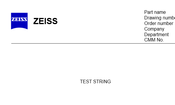

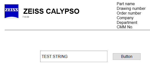

  6. The result of this should be the following: On Page 1, enter a string into the text box and click the button. The second page should display the string entered into the Text Input Field.
