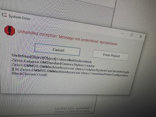

[Ag...] Posted March 6, 2025 Share Posted March 6, 2025 need help on this keep getting this message and don't allow me to do anything Link to comment Share on other sites More sharing options...
[Ja...] Posted March 6, 2025 Share Posted March 6, 2025 Not sure of that particular error, #probeName, but if nothing has changed on your end and this error just popped up try turning your CMM/Calypso off and on again. That sometimes takes care of weird errors. Link to comment Share on other sites More sharing options...
[An...] Posted March 7, 2025 Share Posted March 7, 2025 Unfortunately, a lot of these unhandled exception error messages aren't super useful for troubleshooting in my experience. Knowing what you were doing at the time of the error would likely be more helpful That said, anecdotally, restarting CALYPSO usually resolves errors like these. Link to comment Share on other sites More sharing options...
[Ma...] Posted March 10, 2025 Share Posted March 10, 2025 Can you send me the "equip" folder as a .zip? Its within your config so i would give it a try to repair the config. Path: C:\Users\Public\Documents\Zeiss\CALYPSO 7.8 Link to comment Share on other sites More sharing options...
[Da...] Posted March 11, 2025 Share Posted March 11, 2025 So, just what does that error message SAY? Link to comment Share on other sites More sharing options...
[Cl...] Posted March 11, 2025 Share Posted March 11, 2025 Please sign in to view this quote. Have you tried holding the "ctrl" & "Y" keys? This a User Interrupt. It's worth a try. Link to comment Share on other sites More sharing options...
