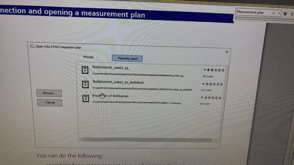

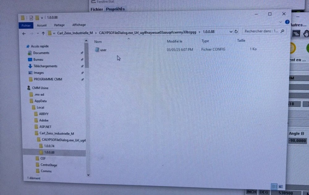

[Mi...] Posted March 7, 2025 Share Posted March 7, 2025 Hello, In our company, we have a Contura G2 with Calypso 7.6. A colleague was performing some measurements and accidentally closed the 'Open Calypso measurement plan' window. Since then, we haven't been able to open it again. This window is very useful because it eliminates the need to manually search for programs, ultimately saving us time. Does anyone happen to know how to reopen it?" Link to comment Share on other sites More sharing options...

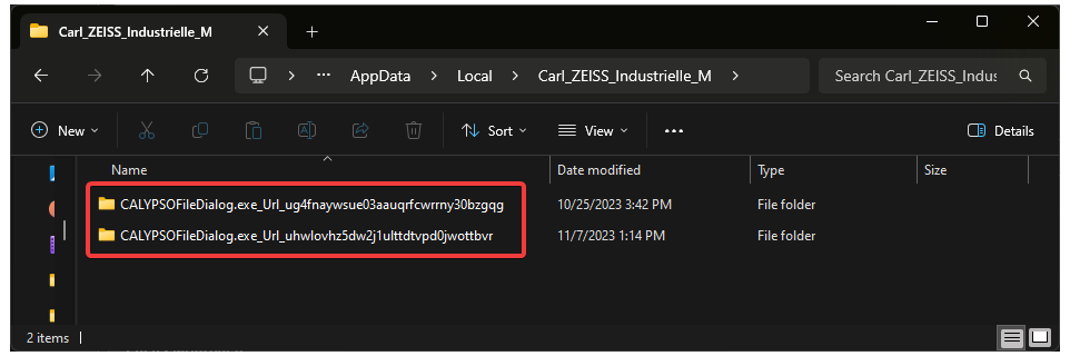

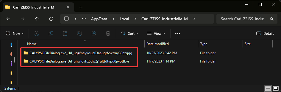

[Lu...] Posted March 7, 2025 Share Posted March 7, 2025 If one would like to disable the window you can “Right Click” > Don’t show favorites again. To undo this setting delete the CALYPSOFileDialog.exe folder located at C:\Users\<USERNAME>\AppData\Local\Carl_ZEISS_Industrielle_M (Note: AppData is a hidden folder, double check that you PC is set to View > Hidden Items.) https://portal.zeiss.com/knowledge-base?id=1444152 Link to comment Share on other sites More sharing options...
[Mi...] Posted March 7, 2025 Author Share Posted March 7, 2025 I want to use this window. Link to comment Share on other sites More sharing options...
[Lu...] Posted March 7, 2025 Share Posted March 7, 2025 To restore the window you must delete the CALYPSOFileDialog.exe folder(s) at C:\Users\<USERNAME>\AppData\Local\Carl_ZEISS_Industrielle_M Link to comment Share on other sites More sharing options...

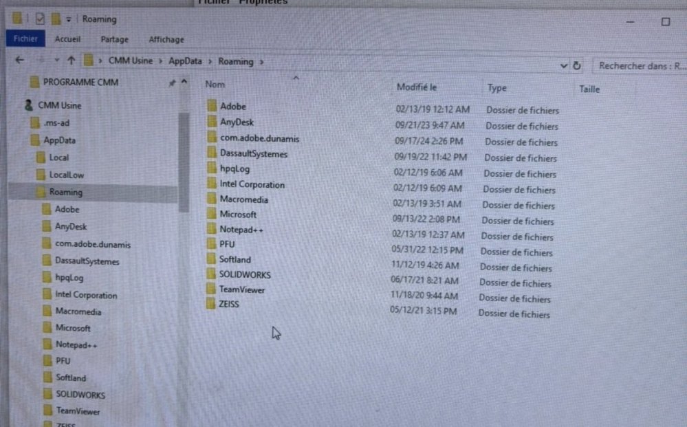

[Mi...] Posted March 7, 2025 Author Share Posted March 7, 2025 I did not find yhis path and not this folders. Link to comment Share on other sites More sharing options...
[Je...] Posted March 7, 2025 Share Posted March 7, 2025 ZEISS Portal - Instructions at the bottom of the article. AppData is a hidden folder. Link to comment Share on other sites More sharing options...
[Mi...] Posted March 7, 2025 Author Share Posted March 7, 2025 No, it is not on the computer. I have already made the hidden folders visible, and the AppData folder does not appear. Link to comment Share on other sites More sharing options...

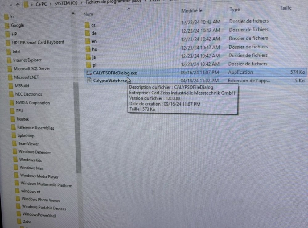

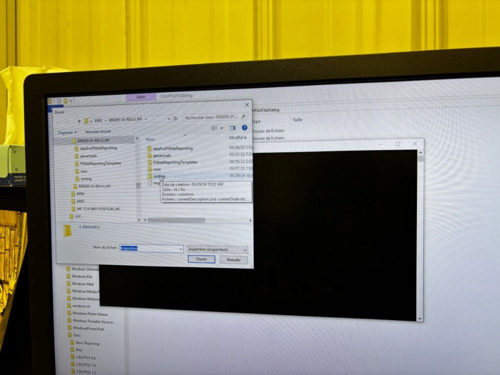

[Mi...] Posted March 7, 2025 Author Share Posted March 7, 2025 But I found the CALYPSOFiledialog.exe. When I execute it, it opens a normal window of the programs and not with the recent programs. Link to comment Share on other sites More sharing options...

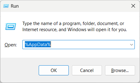

[Lu...] Posted March 7, 2025 Share Posted March 7, 2025 Try Windows Key + R to open the Run app. Type %AppData%. This will take you to AppData > Roaming. Go back one level to find AppData > Local. Link to comment Share on other sites More sharing options...
[Mi...] Posted March 10, 2025 Author Share Posted March 10, 2025 Hello, I couldn't find the application, the version of Calypso is 7.6. Link to comment Share on other sites More sharing options...
[Mi...] Posted March 10, 2025 Author Share Posted March 10, 2025 Sorry, I find, I will try. Link to comment Share on other sites More sharing options...
[Mi...] Posted March 10, 2025 Author Share Posted March 10, 2025 I find this. Link to comment Share on other sites More sharing options...
[Mi...] Posted March 10, 2025 Author Share Posted March 10, 2025 Thank you, I deleted it, and it worked—the window came back. Link to comment Share on other sites More sharing options...
