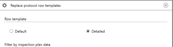

Noob question. I can't remember how to display a graphic of Form in PiWeb report.
Having a grey matter holder day.
I am trying to get the graphic for Form to display and print on a PiWeb report.
Any help is appreciated. 🫢
Hi Rich,
I am making a few assumptions. Primarily, that you just want to display a form plot on the Standard Protocol that populates after a measurement completes. If you only need to see the form plot under specific circumstances, you can toggle it on and off on a case by case basis. With the Standard Protocol open, click the icon that looks like a gear. If you mouse over it, it will say "Replace row protocol templates". Click this, and a new window will pop up. Click the radio button labeled "Detailed" under Row Template. Any characteristics with form data will now include their form plots.

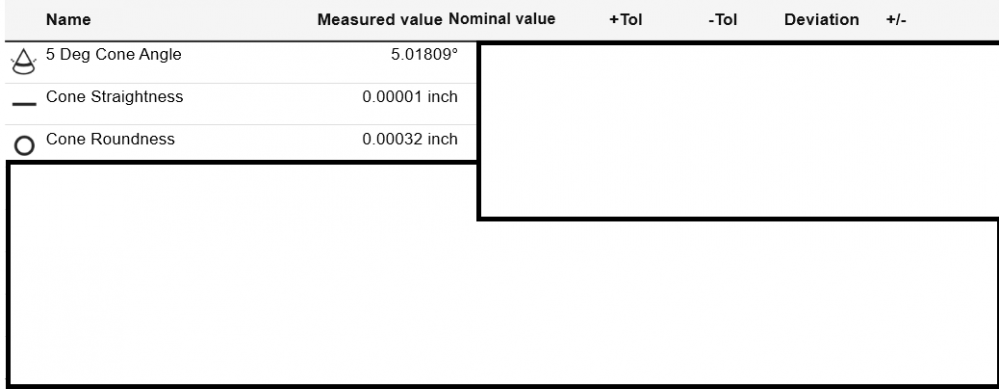

image.png.074bed1497bf9ad5ca06b7e116220257.pngimage.png.14731dd14f944b97e70b28ece17424f3.png
Before (Default is selected, only numbers displayed):image.thumb.png.4b4d9409c05dd4c280b4c35c9581eda8.png
After (Detailed is selected, plots are displayed):

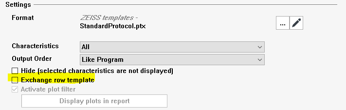

If you want to control this on a program by program basis, in CALYPSO go to Multiple Report and click the check box labeled "Exchange Row Template". If this is active for a given program, the default setting will be to display the form plots.
Let me know if I've misunderstood. I'll do what I can to provide accurate instructions.

Case: Always show plots inline for certain ‘critical’ characteristics
If there are certain characteristics that should always display plots, this can be set in the Calypso program.
Figure 3 Always show inline plots for select characteristics.
In the Multiple Printouts window, Exchange row template turns on the inline plots. If Activate plot filter is selected, only characteristics that are set to “on” will display a plot. You can customize which characteristic should display plots, using the “Display plots in report” button.
