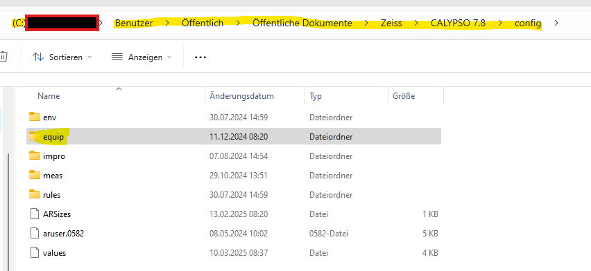

[Ma...] Posted March 10, 2025 Share Posted March 10, 2025 Hello Richard, this can happen if CALYPSO crashes when there is a SQL Database change and the Probe remains in an unknown condition, if you use CALYPSO 2024 you can send me your "equip" folder as a .zip file so i could try to repair it. Path: C:\Users\Public\Documents\Zeiss\CALYPSO 7.8 Link to comment Share on other sites More sharing options...

[Ma...] Posted March 10, 2025 Share Posted March 10, 2025 I've send you a PM. Link to comment Share on other sites More sharing options...

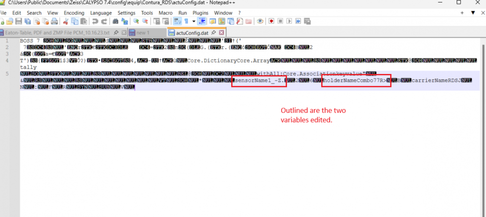

[Ri...] Posted March 10, 2025 Author Share Posted March 10, 2025 (edited) I have resolved this. I renamed "actuConfig.dat" to "actuConfig.dat.old" and pasted in a slightly older file. Lost a few articulations and maybe one stylus. The big change was (It's not a text file, but it has clues) "sensorNameUnknown" and "holderNamenot_defined". Both of these are from the older file, this eliminated the invalid probe name and or rotation. The affected file had "sensorName3_2mm +X" and "holderNameCombo91". The string "3_1mm +X" was 5_2mm -X" prior to the software crash. Edited March 10, 2025 Link to comment Share on other sites More sharing options...
[Ri...] Posted March 10, 2025 Author Share Posted March 10, 2025 Edit for my reply above. Calypso must be shut down prior to renaming and or pasting files. Link to comment Share on other sites More sharing options...

[Ri...] Posted March 12, 2025 Author Share Posted March 12, 2025 The image shows the two variables I edited in the aforementioned file. Link to comment Share on other sites More sharing options...
