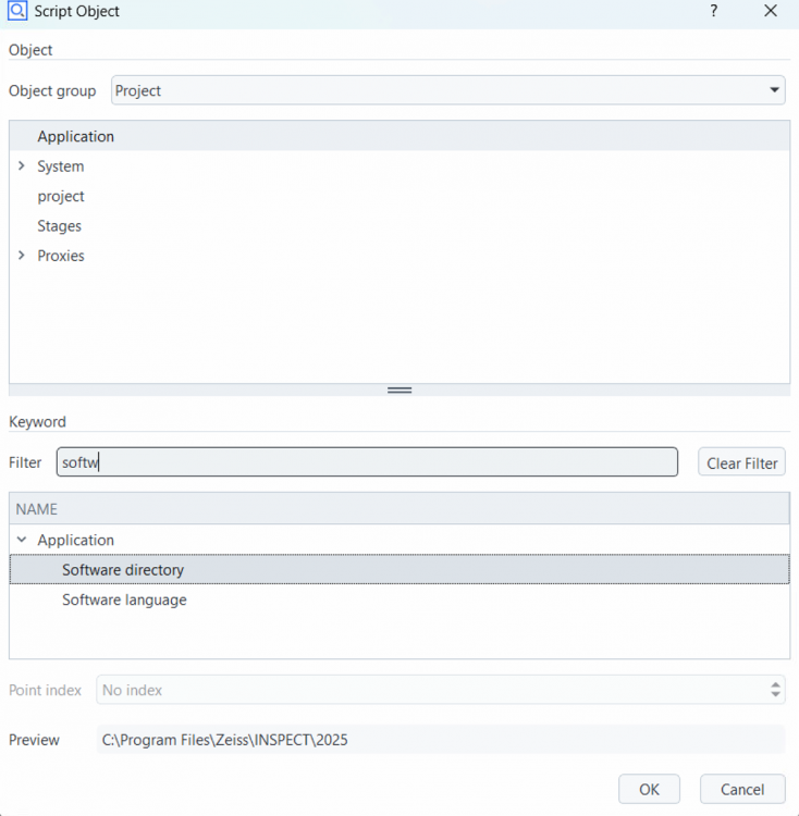

I’m encountering an issue with the ZIP 2025 version when trying to access the software_directory path via Python scripting. I used to use the following code successfully in earlier versions:
# -*- coding: utf-8 -*-
import gom
print(gom.app.software_directory)
However, in the 2025 version, this results in the error:
AttributeError: module 'gom' has no attribute 'app'
In the GUI (see screenshot), I can see Application and things like Software directory working fine. But in Python, gom.app doesn’t work anymore.image.thumb.png.88073bcc89245fa3afa3dd1a3b012f3f.png
Did gom.app change in 2025?
How can I use gom.app now?
Thanks in advance for your help
Edited
  • [Se...] changed the title to ZEISS 2025 Python Script Error - AttributeError with gom.app
I found the problem! It happened because my license was not detected properly while running the script.
What’s interesting is that I could still add new app scripts and do other operations without any issues. Also, import gom worked fine. The error only happened when I tried to use gom.app, and I got this message:
After fixing the license issue, gom.app worked again.
Hope this helps anyone with the same problem!
