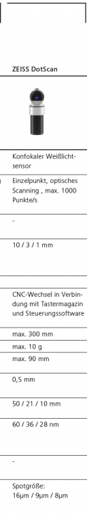

[Cl...] Posted March 12, 2025 Share Posted March 12, 2025 Does anyone know what the diameter (focal point/convergence) of the DotScan light? Link to comment https://qualityforum.zeiss.com/topic/22711-dotscan/ Share on other sites More sharing options...
[Ma...] Posted March 12, 2025 Share Posted March 12, 2025 Im not 100% that this is what you asked for, but it says "spot size" (bottom line) so it might be correct: Best Regards Marcel Link to comment https://qualityforum.zeiss.com/topic/22711-dotscan/#findComment-128125 Share on other sites More sharing options...
[Cl...] Posted March 12, 2025 Author Share Posted March 12, 2025 Yes, thank you! I thought it might be 1mm but wasn't sure. Link to comment https://qualityforum.zeiss.com/topic/22711-dotscan/#findComment-128135 Share on other sites More sharing options...
