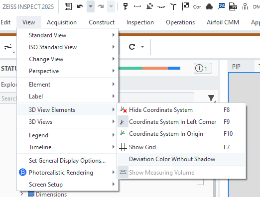

[Re...] Posted March 12, 2025 Share Posted March 12, 2025 Hi, i was working for surface comparison. imported CAD and STL file. Checked surface comparison in actual. but i got a glossy profile . how can i change this to my old normal version of surface comparison. Link to comment https://qualityforum.zeiss.com/topic/22713-surface-comparison-is-in-glossy-appearance/ Share on other sites More sharing options...
[Na...] Posted March 12, 2025 Share Posted March 12, 2025 Hi, please check this setting ("Deviation Color Without Shadow"): Link to comment https://qualityforum.zeiss.com/topic/22713-surface-comparison-is-in-glossy-appearance/#findComment-128113 Share on other sites More sharing options...
