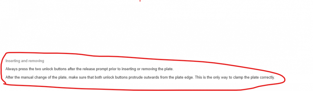

[Ni...] Posted March 12, 2025 Share Posted March 12, 2025 We are purchasing a new Contura CMM with the VAST XTR GOLD sensor. I am looking for clarification on utilizing the ZCR (rotatable) adapter plate. I have come across some text that indicates there are two lock/unlock buttons on the adapter plate. The screenshot below is from the Calypso online help manual. I am hoping someone can provide a more detailed explanation as to when we will need to physically press these lock/unlock buttons. Is it just during manual insertion or removal of a ZCR adapter plate, or will we need to press the unlock buttons even during an 'automatic' stylus system change. I can't find much on the forums or in the Zeiss help pages that shed light on the ZCR plate lock/unlock buttons. Link to comment https://qualityforum.zeiss.com/topic/22729-vast-xtr-gold-automatic-plate-change-with-the-zcr-plate/ Share on other sites More sharing options...
[Ma...] Posted March 12, 2025 Share Posted March 12, 2025 (edited) Here is video of adding new stylus angle - i believe it's just for manual insertion/removal https://portal.zeiss.com/iqr-academy/video/EJTC4oc5Dak76E2YRMj8my Also there is special rack for those plates - can not use VAST rack Here is pdf - starting from 5-22 there is talk about that https://www.zeiss.cz/metrologie/produkty/senzory/on-cmm/tactile-scanning-probe/zeiss-vast-xtr-gold.html https://asset-downloads.zeiss.com/catalogs/download/iqs/e969880b-6fb4-47ad-9864-835ac06d2d00/BA_Sensorik_taktil_REV_1_0_en.pdf.pdf Edited March 12, 2025 1 Link to comment https://qualityforum.zeiss.com/topic/22729-vast-xtr-gold-automatic-plate-change-with-the-zcr-plate/#findComment-128191 Share on other sites More sharing options...
[Je...] Posted March 13, 2025 Share Posted March 13, 2025 the two buttons are only needed for manual change Link to comment https://qualityforum.zeiss.com/topic/22729-vast-xtr-gold-automatic-plate-change-with-the-zcr-plate/#findComment-128199 Share on other sites More sharing options...
[Wo...] Posted March 13, 2025 Share Posted March 13, 2025 The buttons are needed only when you're manually inserting/removing XTR adapter plate from XTR probehead. No need to press anything when inserting into ZCR pocket. Note: you can only use ZCR pockets with Vast XTR. You can use regular VAST adapter plates, but they still need to be inserted into ZCR pockets on the rack (you have to switch the setting on the ZCR pocket when inserting XTR adapter plate or VAST adapter plate.) Link to comment https://qualityforum.zeiss.com/topic/22729-vast-xtr-gold-automatic-plate-change-with-the-zcr-plate/#findComment-128223 Share on other sites More sharing options...
